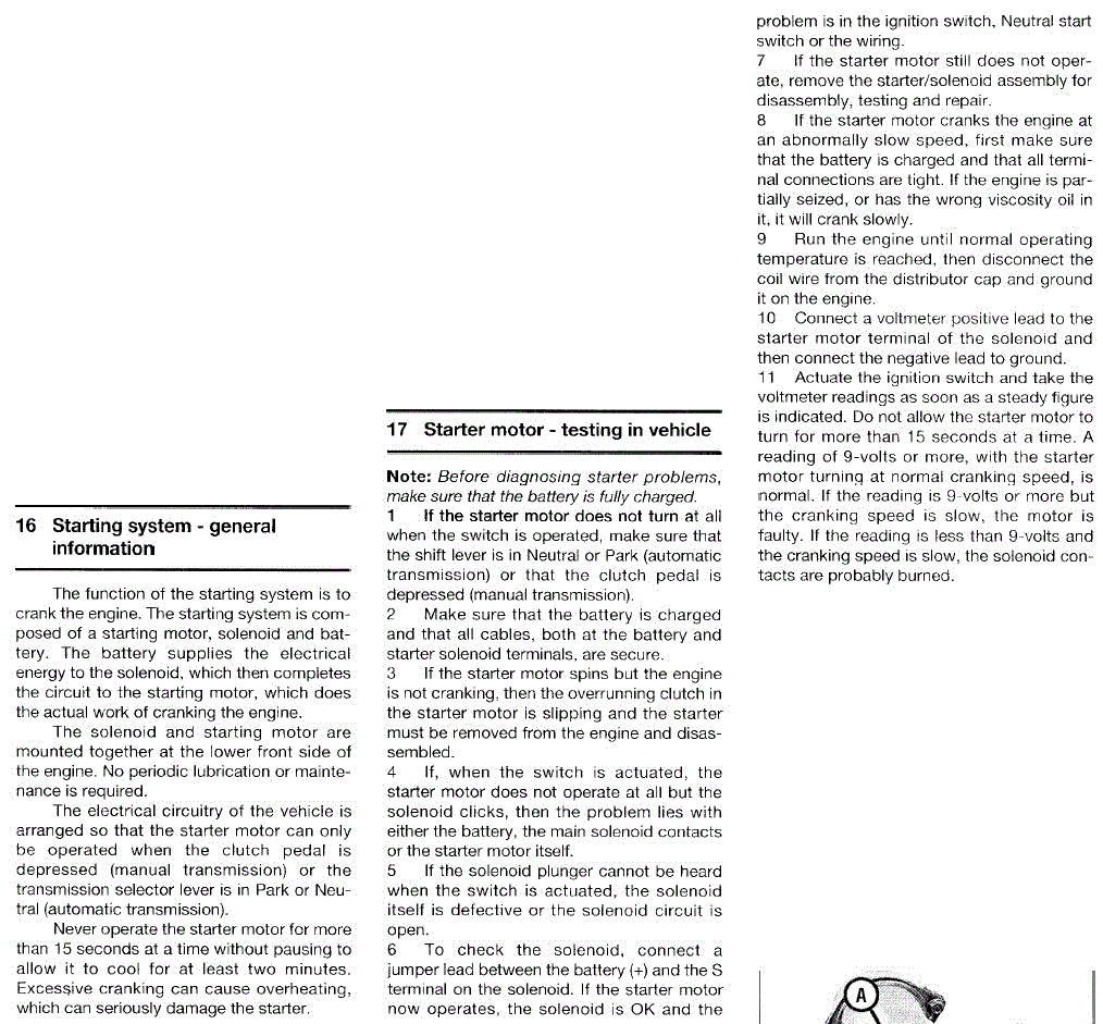

Did you have the old starter tested? (and it WAS bad?) Did you have someone do a "load test" on the battery? The starter solenoid should click when key is turned to START. Does it?
If solenoid doesn't click you have other wiring issues going on...
If solenoid works, at that point it's the battery cables if battery tested as good.

Is this a manual transmission? Check your Clutch Safety Switch...
