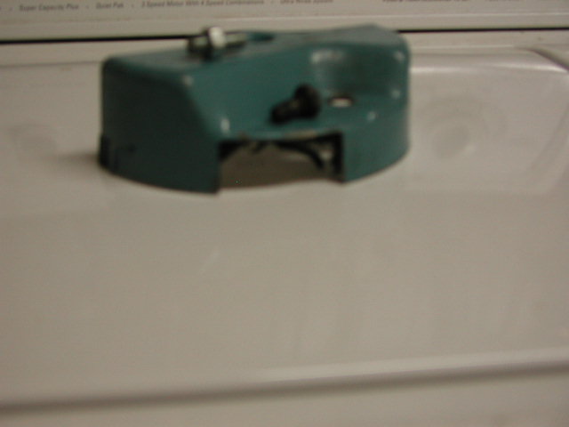

Make sure the bolt is not too long. Could be bottoming out before getting tight against the shield. Here's a pic of mine that I modified years ago to fit the CS130 upgrade. I show bolt vs stud as options. I know the CS130 has a built in fan and a shield isn't required but the heat from the manifold is still present.

AUG 31, 09:30 PM
quote | Originally posted by Spoon:
I would have to disagree with you there. On the '88 Fieros with a 2.8 (which came from the factory with CS130 alternators), a heat shield is still required. However, instead of it being attached to the alternator itself, it's attached to the exhaust manifold.

Spoon
AUG 31, 10:12 PM
I stand corrected. I haven't had to deal with the 88's.
