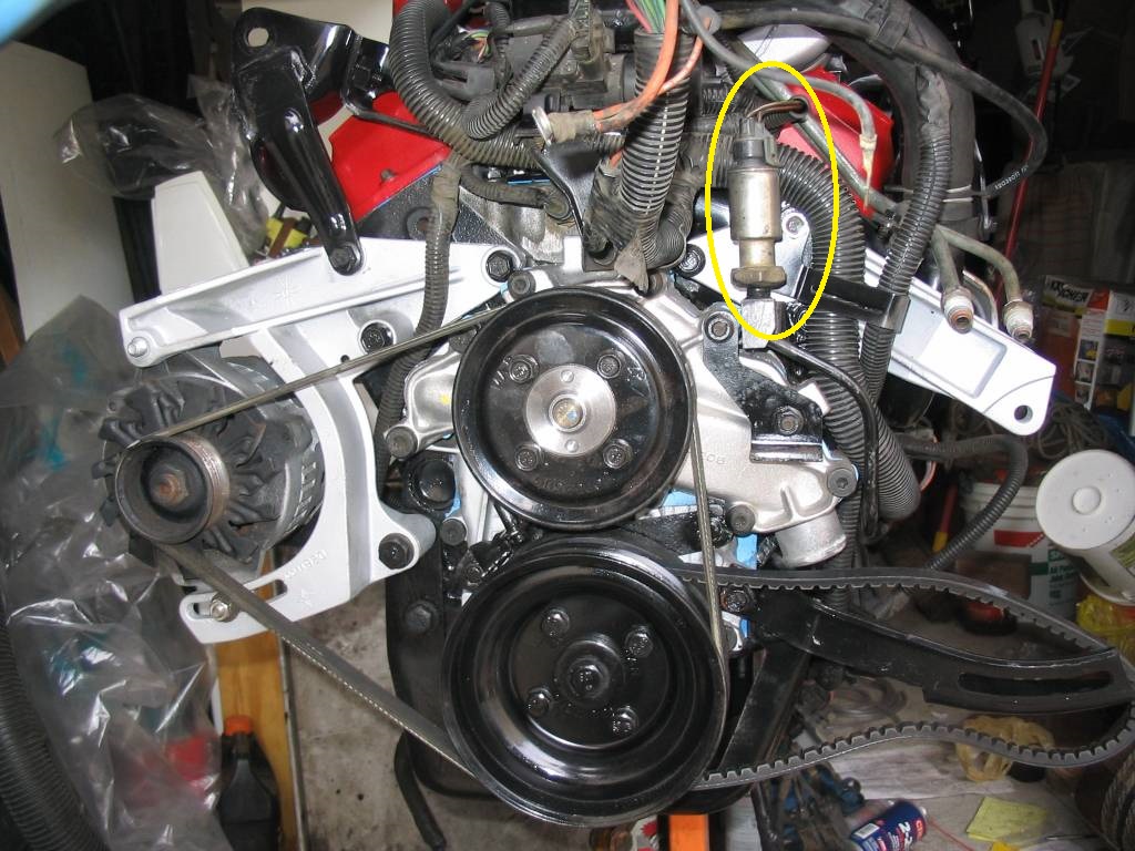

It's been a long time since I've had to deal with mine (as I have Dodgerunner's excellent tensioner installed), but I thought on my bracket the bolt extended out the back of it and a nut was on there. If the indicated hole below is supposed to be threaded, then it's possible mine was stripped and then drilled out... maybe even by me years ago!

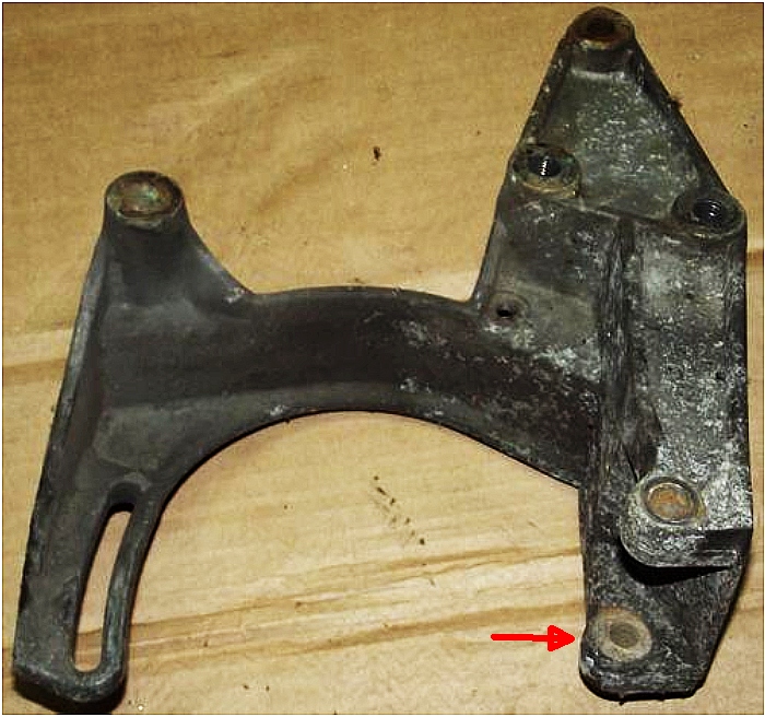

Looks like the brackets were threaded according to this pic I had for something else... aluminum bracket with steel bolt was never a good idea tho....
Agreed...hopefully I can finagle that whole sucker out of there...
