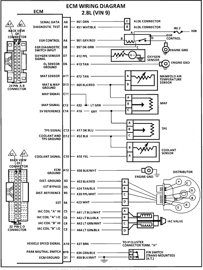

AUG 22, 10:16 PM
Pull your center console to gain access to the ECM. Recheck your TPS circuit. With probes on terminals have an assistant wiggle, poke & prod the harness wires at the ECM and at the TPS connector and observe of any loss of signal on your meter. Also move the TPS arm very slowly thru its travel range while looking for a steady movement on your meter. Any needle jerks indicate a compromised TPS.
I once had a situation with my 2.8 that would shut the engine off while traveling down this highway. I'd push the clutch in and start it back up. It turned out to be a poor connection at the ECM. A white wire leading back to the ignition control module. I could press against that wire ever so slightly and the engine would abruptly shut off.
Here's a schematic from the archives that may help you.
