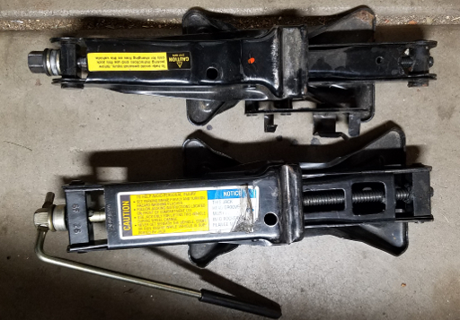

I wanted a jack that would lift my 88 GT at the at the jacking points to just have in my garage, so I wouldn't have to yank the factory one from under the hood all the time. I also wanted one that had a hex drive so I could use a ratchet or an impact wrench and move it up or down faster. The jack for a Saturn S series (GM # 21011868) works well. It's the same basic design as the Fiero jack (in the photo. Saturn jack upper, Fiero jack lower).
The Saturn jack DOES NOT fit in the Fiero's underhood location, at least not without some modifications to car or jack. But it's a good answer for what I wanted it for, especially since I got it for $3 from a local yard.[This message has been edited by OldGuyinaGT (edited 08-18-2019).]
