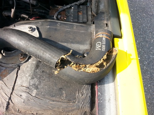

Anyone have a source for the engine compartment heater hoses? I ordered two hoses from the Fiero Store that I thought were for the rear compartment, but they look far too short. They look more like the front compartment hoses to me. Is this a case of just buying a length of heater hose and making it fit. If so what diameter hose will fit. It's an 84 with air. Thanks.

RockAuto has some listed....called 'pipe to water pump'...if that is what you are looking for. [This message has been edited by Gall757 (edited 08-13-2019).]

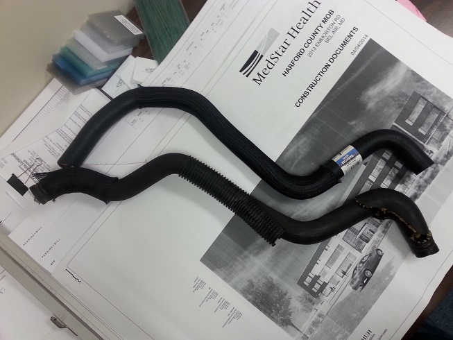

Not sure if this helps you out or if it's the same hose. Mine was an 88 Duke. I looked everywhere but couldn't find either hose. This is the best match that I could find, (Dayco 71881). It worked, just had to be cut a little shorter. (It was the left hose, (I think)).

The ones I found on Advance Autos web site worked out. They were installed yesterday. They are Dayco numbers 88351 and87690. I had to order them as the local store didn't have them. Thanks for the leads.
