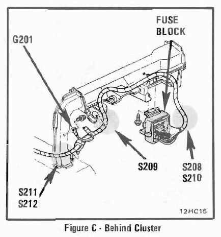

fierosound
JUL 14, 11:42 AM
It could be a bad/loose ground. Location of ground G201
