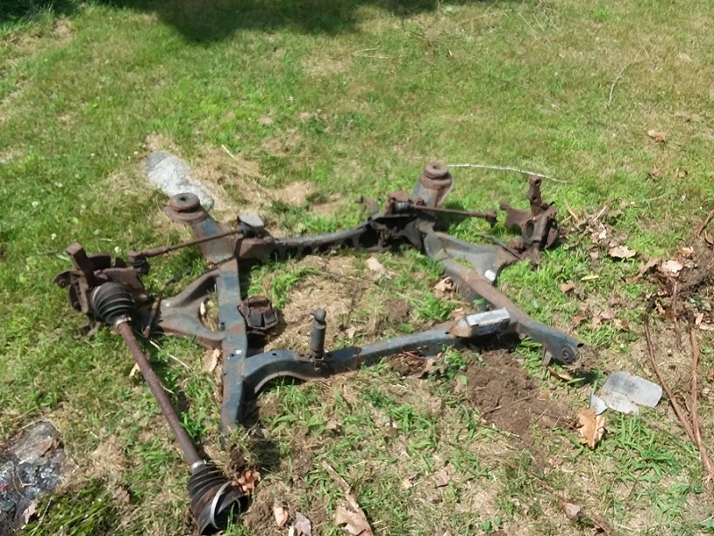

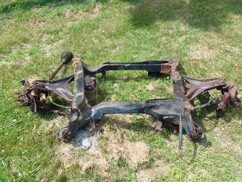

engine man
JUL 13, 03:57 PM
engine man
JUL 14, 12:01 PM
engine is now off the cradle it is n good shape has a bit of surface rust but other than that it is a good pre 88 cradle
