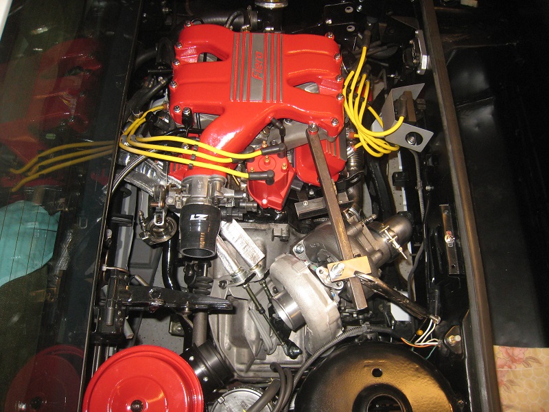

Here I have an example of "the auto modification world" vs. "the 3D CAD world".
To place a turbo in the engine bay, if you have 3D CAD, you would specify the turbo's XYZ coordinates, and the 3 angles to fully define it. Then, you look around for clearances.
In the auto modification hobby world, I didn't have the CAD of the Fiero. Yet, I managed to position the turbo (all translation and rotation degrees of freedom defined), in a spot having just about 3/8" clearance in places. I built an adjustable support that allowed me to finely adjust the position and angle... effectively simulating what a CAD user does:
Once the position was locked in, and the turbo inlet flange welded to the exhaust piping, the turbo was fully defined. At that point, the adjustable support was discarded.
Sounds like you just need to adjust your work methods.
