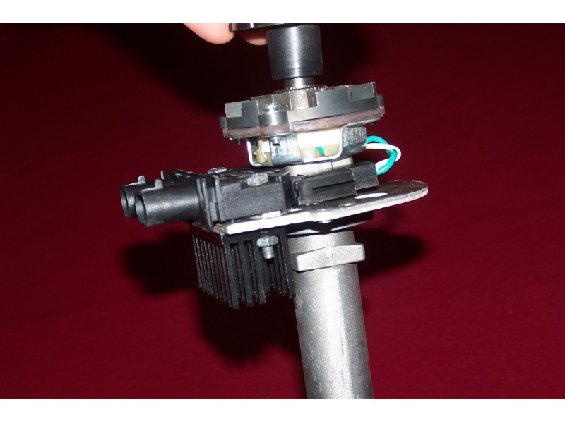

I was kind of wondering about that. However, I recently replaced the Distributor (which includes an Ignition Control Module) with a Richporter #GM17. Before installing, I put on a big heat sink on it.
Then not long after installing, the common "oil leak" started, so it had to come out again and replaced the seal with one of the really good ones (from RodneyDickman.com I believe). Anyway, it's all still pretty new, do you think the ignition control module could still be the issue? I wonder if ICM that Richporter uses in their mfg process is a quality product....?

Adding a heat sink is a great mod (as long as the proper thermal compound is used between the heat sink, the distributor base and the ICM), but it's possible the ICM used by Richporter is of such low quality that it's failed quickly despite adding the heat sink.

I checked my "Fiero Spare Parts Bin" and found that I had a new AC Delco ICM still in the box. So I removed the Richporter ICM (which was stamped "Made in Canada"... false since of quality? ) but in doing so, I had to remove my heat sink (it was fastened on using the same mounting bolts for the ICM). Pretty much impossible to put it back on without pulling the entire Distributor, and I wasn't going to do that. So it's back to the way it came from the factory.
