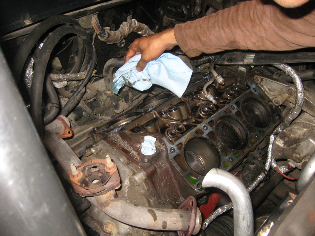

I don't think this mess can be fixed without pulling the heads from the engine.
It is possible to strip the engine down to the long-block, without removing the engine from the car. Just take parts off one at a time, and you'll get there. I did just that about 10 years ago:
Spray WD-40 on the engine block so it doesn't get rusty from the humidity outdoors. When you're not working on the engine, put a garbage bag over it to keep out the dust/water.
The head with the broken boss for the exhaust port flange could be repaired (brazed?) by a competent machine/repair shop, but it would probably be cheaper/simpler to get a used Fiero head to replace it.
On the "good" head that probably has broken bolts stuck in it, I'd avoid using easy-outs. Easy-outs are how people turn a relatively easy stuck bolt problem into a worse broken-off easy-out problem. I like to weld nuts onto broken bolts to take them out. If you aren't comfortable dealing with broken bolts in the head, take the head to someone that knows what he's doing before you get in over your head with this.
Before reassembly, chase all threaded holes with a tap.
I'd suggest using the Volkswagen exhaust gaskets; they're cheaper and better than the stuff sold for Fieros.
Use anti-seize on your exhaust fasteners.
You'll have to adjust the valve lash as you reassemble the top of the engine, but that's fine; readjusting the lash is a good tune-up item.
If you don't think the oil pan gasket is leaking, don't touch it; it's not easy to do correctly from underneath the car.[This message has been edited by pmbrunelle (edited 06-29-2019).]
