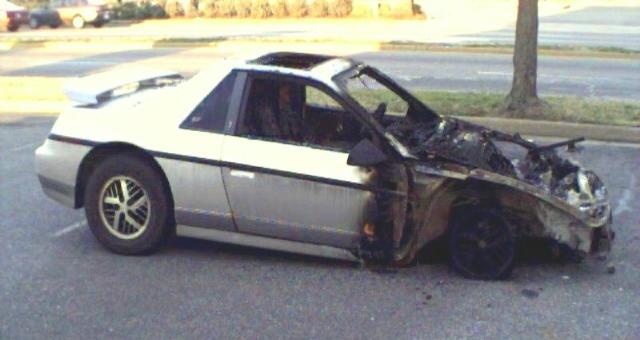

turn off the heater and read this thread!
Potential Fire Risk - Check out your blower motor resistor ASAP

If the smell is the heater resistors, you won't smell anything until you run the heater at a low setting. I think the temp gauge is a separate problem....maybe the connector is failing.
