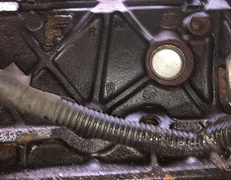

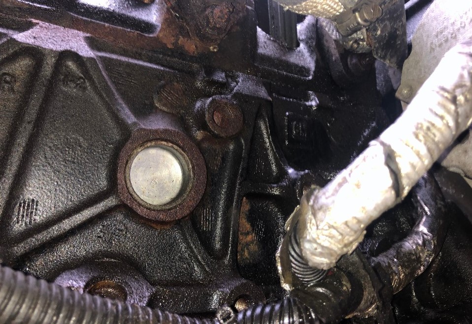

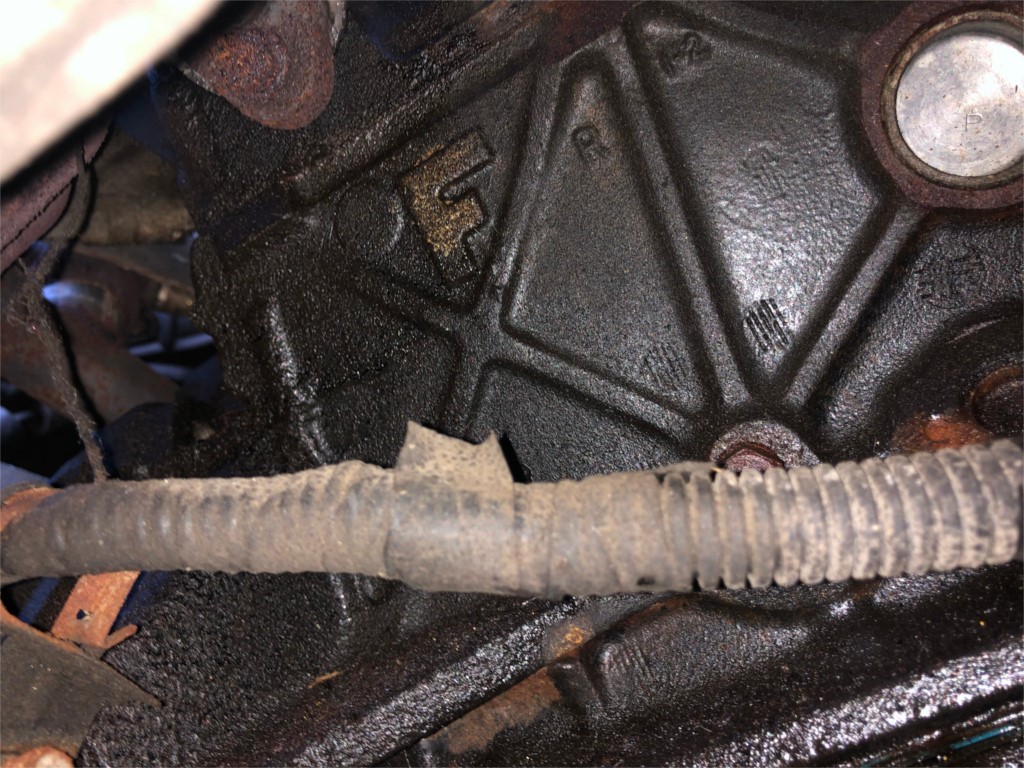

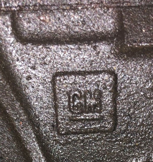

fierofool JUN 18, 03:02 PM
If you found a big "F" just above the starter and on the opposite side near the rear freeze plug with ribbing running outward, then you have a 3.4 pushrod engine from a 93-95 Camaro or Firebird.

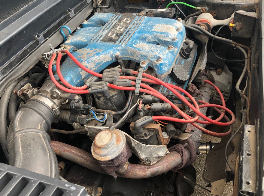

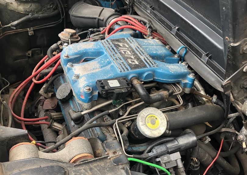

atv_123 JUN 18, 06:04 PM
Alright... this took me a while as my computer really didn't want to cut down the images for some reason.
I also slapped a magnet onto the heads... they may look aluminum to me, but they are definitely iron heads, so you are definitely correct... I am sure your not surprised by that.
Now these images are of the rear of the engine (the side facing the rear of the car) as I can't even get my phone up in to take pictures on the front side of the engine... there is a lot of stuff packed up in there.

Raydar JUN 18, 06:15 PM
Yup. Most definitely a 3.4. Camarobird motor. A very popular swap for the Fiero. Many people say that it's the engine that should have come in the Fiero, from the factory.
Depending upon what has been done, you're probably looking at ~165-200 HP. (Stock 3.4 is ~160. Ported heads and intake, a big cam, and tuned headers will get you closer to 200.)
Have any pics of the car? Someone here will probably recognize it, and maybe even identify the build. There might even be a thread on here that documents the whole thing.
Oh... Welcome to our obsession!
Edit - Based upon the orientation of the shift cables, you have the Isuzu tranny. I had one in my 3.4 car for a while.
It's a nice shifting trans, but you don't want to shock load it. (IOW, no "clutch dumps" or speed shifting.) 2nd gear is usually the "weak spot".
If you want to "beat on it", I might suggest a Getrag swap, or even better, an F23. But if you drive it sanely, the Isuzu will do fine.

Patrick JUN 18, 06:37 PM
Originally posted by atv_123:
You definitely want to either replace the factory heat shields that are missing on the exhaust crossover pipe... or heat wrap that pipe. Your ICM will thank you.
