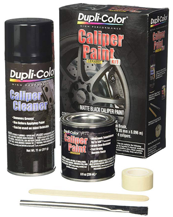

Any of the brush on brake caliper paint kits. They dry extremely hard and are resistant to all chemicals. Also the paint is self-leveling which ensures a super smooth finish. Do NOT use the spray paint style caliper paint. It will just chip off of your brackets.

The roll cage paints seem like the best bet. However I like the caliper paint suggestion..
I might do both on different brackets just to see which one lasts longer.
