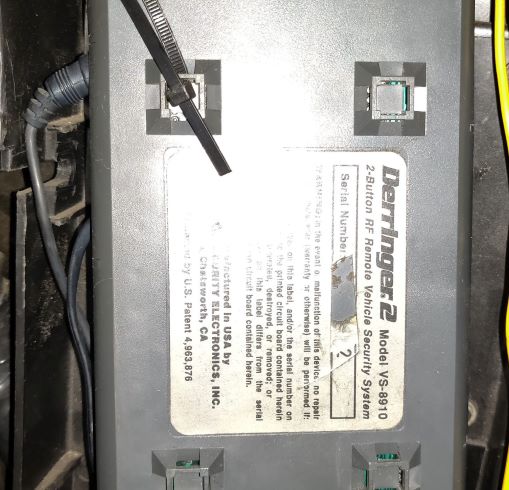

Ladies and gentlemen, I give you the culprit: The Derringer 2: 2 way RF remote security system.
This thing is so old that searching for the model number only yields two pages of results. Most of them being forum posts asking, "WTF is this thing?" There is next to no documentation I can find, so I just unplugged everything running to it. No issues with the lights now, car starts and runs just fine. Can anyone think of a reason I should troubleshoot further?

No surprise... many have old crap like that in a car. I would follow the wires to cut power at minimum. Rest doesn't matter much but make sure any plugs to it can't short to ground. Besides power likely has horn and lights attach to it that causing problems and could blow fuses etc on other circuits.
I had a Very old Car Cell phone w/ main unit under the carpet on rear firewall behind P side seat. I Cut power wire to it 20+ years ago but finally had to pull the seat to dry the carpet so I removed it last year.
