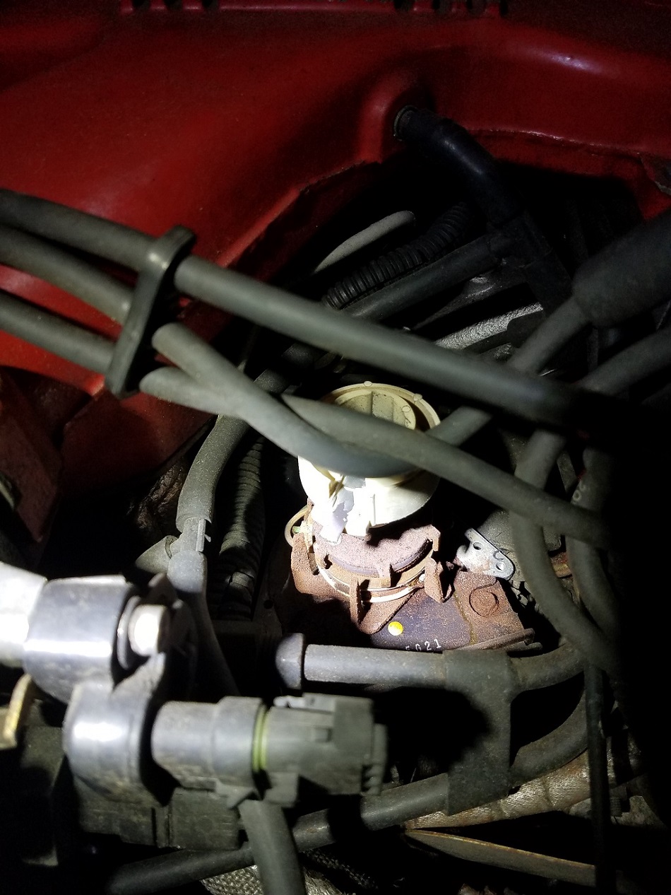

I'm new to this forum and new to owning a Fiero. I'd really like to restore this vehicle and get it to a "reliable" state. It was put together by an aeronautical engineer who owned it for a number of years. Then it was sold to a second owner who neglected the hell out of it. It sat for 2 years not running before I went and trailer-ed it home. It's an 87' GT. It has a turbo, not sure if that is stock, I'm guessing NO. Anyhow, after several hours of prep work, I got it running. I went through a whole tank of gas and half way through another until it DIED... engine just turned off... no sputtering, hiccups, lurching, etc... just STOPPED. I got a ride home, came back with the trailer and brought it home. Started testing everything and found it has NO SPARK. It was running fine... then no spark... I'm a little lost. I took the distributor cap off (never seen a distributor like this before LOL) and it looked like this (see picture). It looks like trash to me... but again... first Fiero so I have no idea what's normal, etc. I'm looking for any wisdom in this area as to why it was running, and now suddenly it's not, AND what you think of the distributor's condition, AND any trouble shooting steps, etc I can take to identify the NO SPARK problem.

Chances are the ICM (ignition control module) went out. In that distributor is the ICM. It's that black triangle looking piece with a 2 pin plug on it. Try changing that out and see if that fixes it.

To add to Spadesluck;s info, the inside of the distributor isn't attractive. Ozone created by the spark between the tip of the rotor and the plug wire contacts causes the inside to rust. Yours is in great conditon compared to some, and they just keep on running. Don't worry about it.
When you replace the ICM, you may find a small package of heat sink grease inside the box. If it's clear, throw it away. Ask your parts store if they have a tube of heat sink grease in either white or silver. You can usually find it at an electronics or computer store. White and silver conduct heat much better. Put a good even coat on the metal plate on the bottomof the ICM and install it. Don't overtighten the screws that hold it down. They are very fine threads and the screws are usually aluminum. Just use your fingertips on your tool to tighten them down.
The pickup coil pigtail that plugs into the back of the ICM is a little long and as such can easily be pinched between the distributor base plate and the cap. Twist the wire a bit so it's twined around itself. That will help to shorten it and keep it from being damaged.
Congratulations. Good grab. Welcome to our side of Pontiac Excitement.
Edit to say----When you purchase your ICM, get 2. This is the one item that most V6 owners carry as a spare, along with some heat sink grease. You may never need it, but when you do, you won't need a trailer to get the car back home.[This message has been edited by fierofool (edited 05-17-2019).]

The coil is separate from the distributor. It's an actual electromagnetic coil, a black black box(ish) a few inches on a side, IIRC farther towards the back of the car. Follow the center spark plug-looking wire from the distributor, it's the shortest one. On the other end is the coil. I wouldn't bother with a spare for that.
The ICM fails as it's a semiconductor and doesn't like heat, which is why all the talk of the thermal goop. If you've ever built a computer, it's just like the CPU, where you put thermal goop on it to pass the heat onto the cooler. This is the same, but the cooler is just the metal plate at the bottom of the dizzy.
The only time you need mark position on the distributor is if you remove the whole assembly. At that point you'd be retiming the engine, which is easy enough, but you should probably have a service manual or read up on it here first. You shouldn't have to remove the distributor to replace the ICM, so don't leap into that just yet.
As for the bits inside the dizzy, maybe blow it out with compressed air. I wouldn't go whacking it with a wire brush or anything ... maybe like a brush with plastic teeth (get them at the auto parts store) or an old toothbrush, if it bothers you that much. I haven't bothered.

dremu, thanks for the input. I found some at my local auto zone and saw pictures of it. It's got a metal base plate which I imagine is where the thermal compound goes? AH, so the distributor does not need removal to replace the ICM, got it. I'm not going to clean it/brush it off if it will work fine as is... it just looked fuzzy with debris so I figured I'd ask if that'd normal or needed attention. I also looked at the cap and button. They are seriously scorched... the inside upper half of the cap is almost completely WHITE lol. The button looks like the end has been melted back... so I'm going to change these as well... only like 20 bucks for a new set. Gonna go pick them up shortly and get them installed and report back. Thanks again for the help =]
