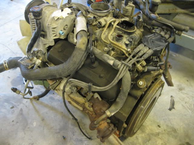

EGR tube connects to Bank 1 (cylinders 1, 3, 5), so if the issue is Bank 2 it won't be EGR tube related. Here is a pic from one of my engine way back when. This shows the EGR tube running down the intake and connecting to the driver side (Bank 1) exhaust manifold.
