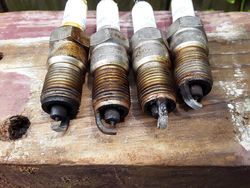

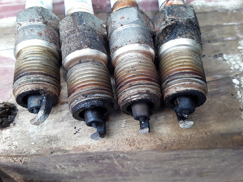

Sweet. Here are the plugs as pulled. Grody, huh?

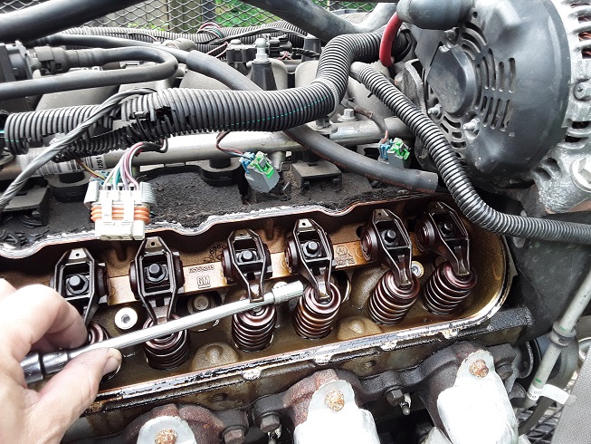

Every LS4 is a DoD engine and it isn't uncommon for a DoD lifter to collapse. I would pull the valve covers and see if any of the pushrods are excessively loose. If removing the valve covers doesn't reveal the issue, then pulling the pan and rod/main caps to inspect the bearings isn't hard to do either.
sourmash
MAY 04, 11:01 AM
Well, you called it correctly and are making me feel much better about the buy. Number 4(?) intake is collapsed, as you can see my 1/4" extension stuck underneath the sloppy rocker. Kudos to you for that info! So, I'm guessing the fix is to pull heads and remove the DoD lifters? EDIT: I've seen the video of CrazedPerformance using the modded pushrod to release the lifter. Will it last if the DoD is defeated permanently? Additionally, If I go forward with a Fiero swap I've lightly read about issues with intake replacement and DoD internals conflicting?
