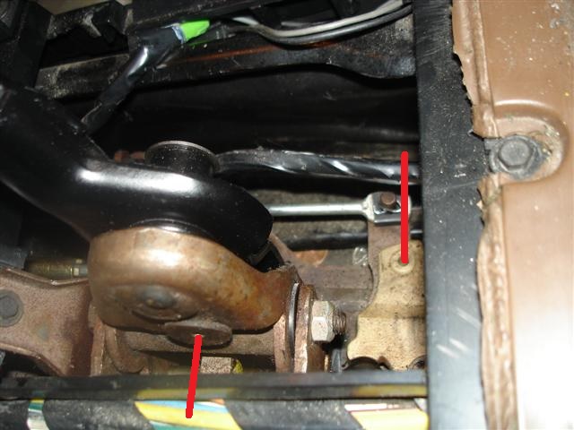

Could you show me with a picture what's the nut that i must have lossed ?

But for the last part i have uplaoded an image, could you tell me if that's the first or second red arrow at the below image for the nut ?

fierosound APR 10, 10:43 AM
Put shifter in 3rd gear. Insert 1/8" drill bits in alignment holes to lock shifter in place.
Only shifter cable attaches to slotted hole in arm. (no adjustment for select cable from below)
Loosen nut, ensure arm feels like it's in 3rd gear "notch" in transmission. Tighten nut.
Proper routing of cables should prevent binding.

I have appreciated a lot your images
olejoedad APR 10, 04:40 PM
Number two is the adjustment nut.
