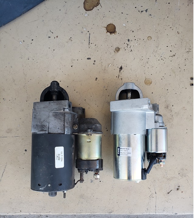

I decided to replace my (slow) working starter with a better one. My biggest reason to do this was because how long it took to start the car. Many times I had to do it twice. The motor is a fresh rebuilt 2.8 that is modified some.
I used a TYC 106472 from RockAuto. This is for a 3800SC Regal 97-2004 or Grand Prix 97-2007. There are other applications that it will fit but you get the idea. This particular model is 1.6KW. The difference between the old and new starters is amazing. The new starter will start the car is about a second.This is very much worth doing for anyone I believe. I did have to trim the metal shielding some that goes around the starter. No big deal. This model was only $69 with no core charge. Also should add I didn't use and shims.
Picture to show the difference:

Spadesluck APR 09, 01:35 AM
I was less concerned about the weight as I was more concerned about fixing the slow start. It is lighter because it was easier to hold it with one hand while installing it but I couldn't not tell you how much lighter. Being smaller does make it easier to work with.

    Spadesluck APR 10, 12:37 AM
    I did this mod, for weight reasons. Here are my old notes:
    Stock starter: 14 lbs
    Reduction Starter: 8 lbs
    I measured that both the stock starter and reduction starter turned over my 2.8 at 180 to 190 RPM; no difference in cranking speed.
    Jason, if you noticed a difference, maybe your stock starter was already on its last legs. Or maybe my reduction unit sucked?
    Patrick, I can guarantee my stock unit was probably close to the end of its life for sure. There is a huge difference in the starting power of the two for sure.
    Spadesluck APR 10, 12:39 AM
    Spoon, when I was shopping the different starters I just took the middle ground at picked out the best price 1.6KW. Which is how I ended up getting the TYC unit. RockAuto has a lot of options, albeit some of them did not show the KW power so I didn't pay them any attention.
