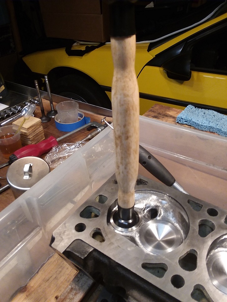

This is my set up ... I don't see where a spring would go :/

I've added a picture of my set up. this is like the Youtube videos that I've seen. No one seems to be having issues of the suction cups continually letting go.

Between the underside of the valve and the head. Otherwise, the full weight of the valve is pressing on the seat... and your suction cup slips off because there's too much friction.

I don't know if the diameter of the dish in the valve face is somehow interacting with the perimeter of the suction cup.
Anyway, you could try hot melt glue; I often use hot melt glue for temporary mockup type things. When you're done, hot melt glue easily peels off with the application of isopropyl alcohol as it seeps in between the hot melt and the component.
Are your hands high up on the wood stick? This is to avoid placing a side load at the bottom which could cause the suction cup to unstick.[This message has been edited by pmbrunelle (edited 04-02-2019).]

quote | Originally posted by Patrick: Between the underside of the valve and the head. Otherwise, the full weight of the valve is pressing on the seat... and your suction cup slips off because there's too much friction.
Ah hah, I get it now!! There is no such spring in my hardware drawer but will look for something at Home Depot or fashion something homemade.
As far as where I am holding my hands, they probably ARE closer to the valve end than higher up the tool so I will try to break that bad habit.
As far as hot glue goes, not a bad idea that. Shall try that if the top two remedies still leave me scrambling. I forgot to mention that I DID already try running a glue stick over the suction cup before attaching and sometimes that helped a lot but mostly just made it worse. Perhaps the glue was not semi-dry and sticky yet in those cases where the tool came right off.
