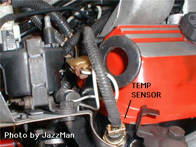

Going over a hard bump once in a while, the dash indicator light for Coolant Temp lights up less than half a second. Actual engine temp gauge, coolant tank, rad and fan working as expected. Loose connection? Thoughts?
fierofool MAR 30, 07:24 PM
Check the Temp Gauge Temp Light sender at the drivers end of the trunkside head, next to the #5 exhaust port. It may be your problem. It will have a green and a green with white tracer wire coming from it. If you need a new harness end, Rodney Dickman sells them.
fieroeffect MAR 31, 04:26 AM
Hey thanks!
Is there a diagram you can point out where to check by any chance?
Thanks
Gall757 MAR 31, 09:19 AM
The connector is probably coming apart......
