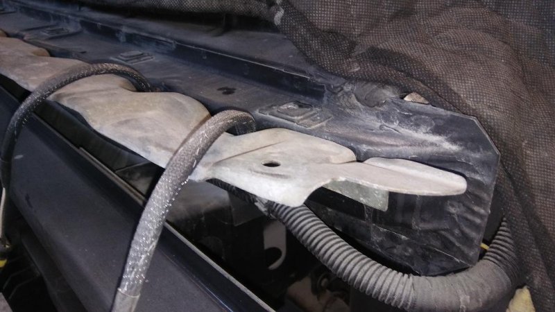

Interesting "'88 Formula uses a rigid plastic shelf"..My 88 GT has a Galvanized coated Steel shelf..pretty robust.

MAR 27, 07:53 PM
quote | Originally posted by Orig88GT-NC:
Hmmm... I can't tell very well from the picture (although it's a good shot), but that appears to be more robust than the metal shelf used on earlier years. I wonder if it's possible in '88 that the notchies/Formulas got the new plastic shelf and the GT's got an improved metal one?  [This message has been edited by Patrick (edited 03-27-2019).]

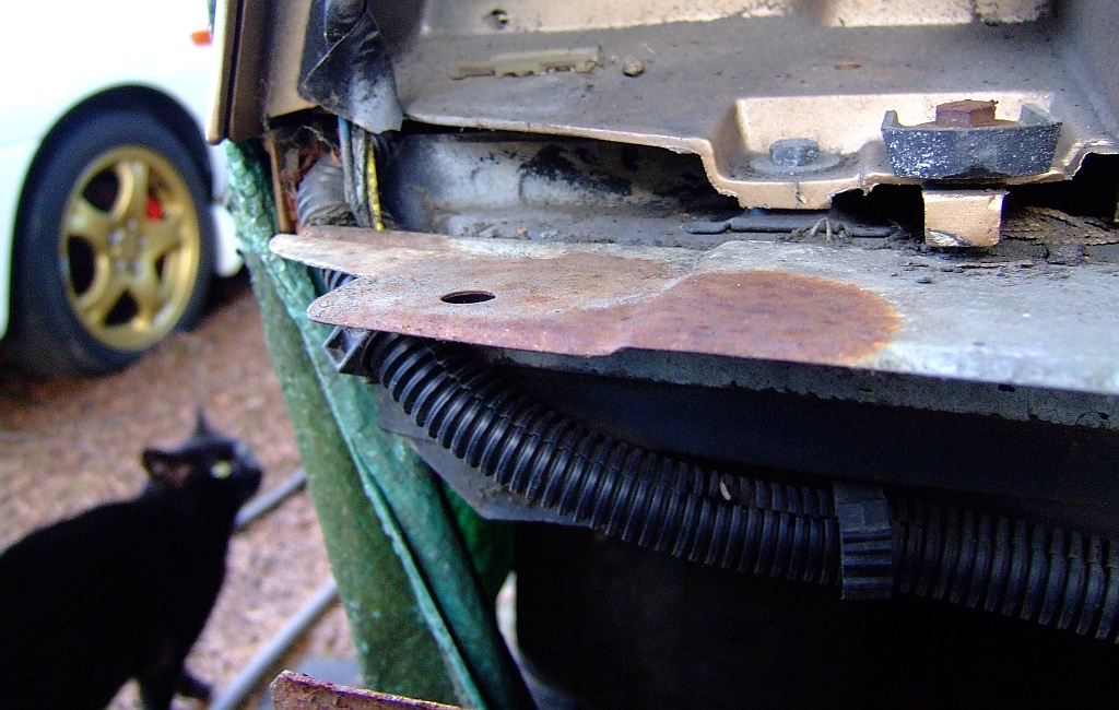

As it turns out, I only had to go into my backyard to answer some of my own concerns.
Pictured below is the rear bumper support on an '86 GT. The metal has evidence of corrosion, and it's quite flimsy... easily bent by hand. It's the same as the one on my '84. I also have a base model '87, and it's rear bumper support is metal as well... but it's not corroded, not flimsy, and not able to be easily bent. I didn't take a picture of it, but I suspect it's exactly the same as the one on the '88 GT pictured by Orig88GT-NC above.
So it would appear that there are at least two different types ('84-'86 and '87-'88) of metal rear bumper supports (the later one stronger than the earlier version) and at least one plastic version. I didn't mention it earlier, but I also found the plastic rear bumper support on an '88 base model... so possibly it's found on all non-GT 88's.[This message has been edited by Patrick (edited 03-27-2019).]
