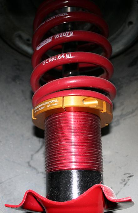

What he's dealing with is a complete pain in the ass. I had the same issue. Basically, they make the spring so short that even with the nut cranked all the way to the top, if you jack up the car, the spring falls out of the perch. I had to cut a 2.5" exhaust piece and use it as a spacer as seen in black:
I've since gone to full length coilovers like the photo from fieroguru.

There is my issue! If these coil overs didnt cost as much as they did, I would totally toss them and go in a different direction. How tall is that black spacer if you had to guess? I am starting to put this basket of nuts and bolts back together again this weekend I will make up a piece of pipe so I can install those coil overs
IMSA GT
MAR 14, 09:59 PM
I believe they were 2 inches tall.
