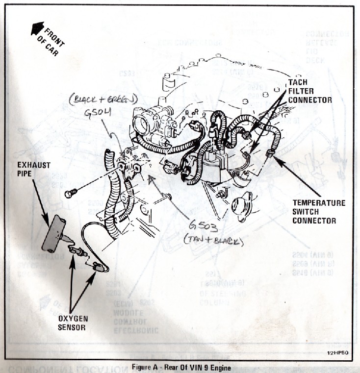

It definitely is a grounding problem. Examine the work done on the clutch replacement....there may be some ground wires still not attached. Here are a couple that are often overlooked.......
