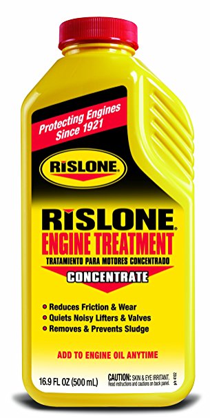

It's common on the V6. I used an oil additive and the smoke went away after a few months. I think the valve seals get hard or dry out. hot oil will sneak by more than cold oil. If you changed oil recently, perhaps your new oil is thinner than before.
