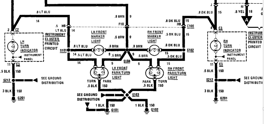

Gall757 OCT 31, 11:04 AM
I would take the parking light apart and look at the socket carefully. There is a bad ground (maybe at G101?). Visit the Ogre's cave for a lot more info on 'sneak path' electrical problems.

theogre NOV 01, 12:58 AM
See my Cave, Sneak Path

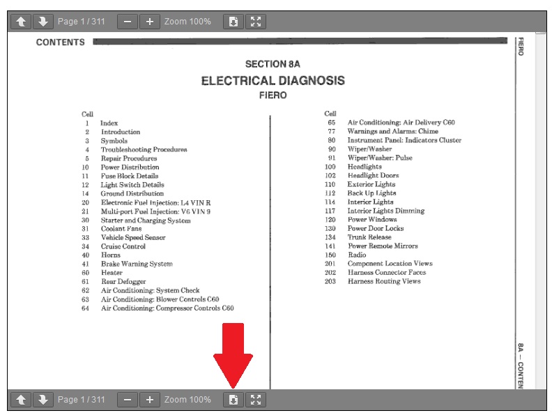

fierosound NOV 01, 10:25 AM
https://cardiagn.com/1987-p...e-repair-manual-pdf/
Click this button to download that section of manual as a PDF
theogre NOV 01, 11:18 AM
Doesn't do damage to the car but likely front turn/park bulb isn't working right as covered in my cave.
