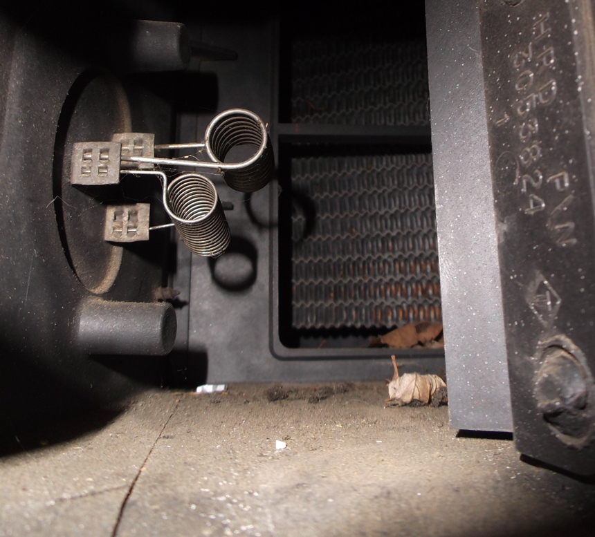

Found because I had to replace the blower today... Doesn't look bad right? (Pictures from a small camera turn sideways thru heater blower hole then rotated/etc to show here.)
Remove resistor and carefully stirred up the crap... Looks worse now because shape of box hinds more.
then carefully used a vacuum thru the blower hole.
end result (Little out of focus but not taking blower out again.)
Note the bend fins from earlier cleaning...
Many don't have a screen to protect the AC evap and very easy bend the fins even when you're careful.

I tried just removing resistor pack but even with something to stir up crap can't reach all then suck out the resistor opening.
I have a heat only box in a parts car that I'll take picture inside later. Not sure if they have same level of this problem.
AC Evap is slanted in the box so airflow forces most junk to the resistor side. Heat only boxes are different.

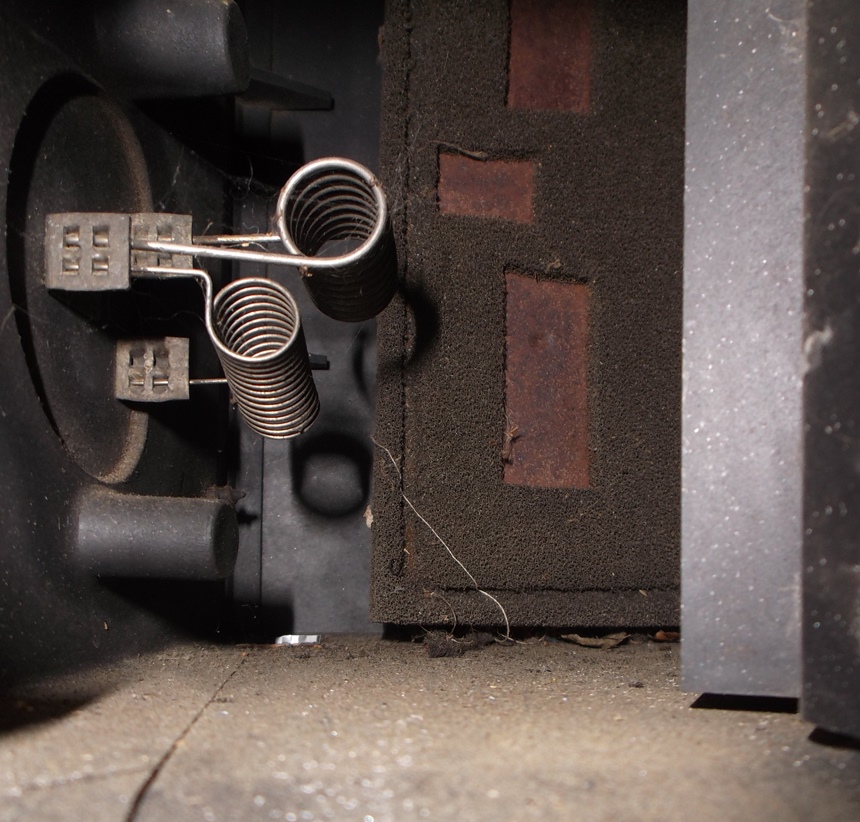

Here's heat only box inside, pic thru blower opening on my parts car... There is a door, hot/cold door I think, that closes heater core there. (Control head inside of car is missing.)
Seem like heat only box is more open to let a lot of crap thru unlike AC/heat box above that pushes crap towards the resistor. I would clean it if you pull the blower for any reason but doesn't look as bad as a fire hazard for most things.
Resistors look better because how it's made but small junk may get stuck, pic shown some burn crap (and some cob webs) on the resistors, and so cleaning out all crap can help.
If mice etc moves it you must clean and use Lysol etc too.
Not sure how you can clean the door... Old Foam likes to fall off making a bigger mess to deal with.
