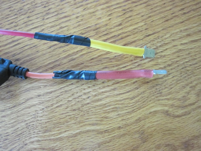

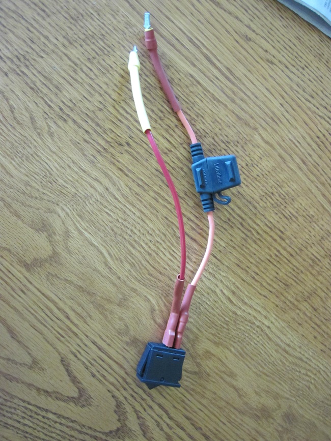

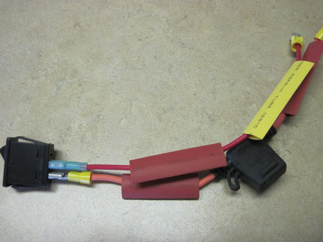

So I made up a simple harness that plugs in to the fuse block.

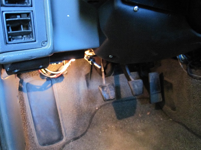

The harness has a fuse holder and a switch and two spades that go in to the fuse block where the 25A fuse for the wiper system is. I had to cut the insulation off the spades as they were too big to go in that way. I repositioned the shrink tubing to cover the bare metal. They fit nice and tight and should not work loose. I also changed the cheap rocker switch for a toggle. I found that operating the rocker switch was very difficult while sitting in the car, the toggle switch is much better.
While not what I would consider a permanent fix this is great until I get my new steering wheel and fix the OEM stuff.
