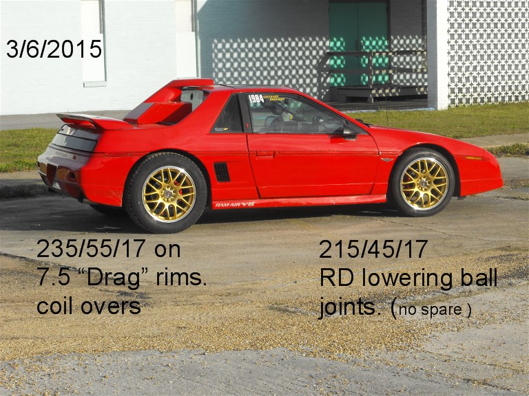

FFIEROFRED
DEC 03, 09:17 AM
This is what I use on my V8 fiero. I like the tall side wall. It helps to close up the wheel well and I can stall the converter to 2800 rpm and dead hook it.
