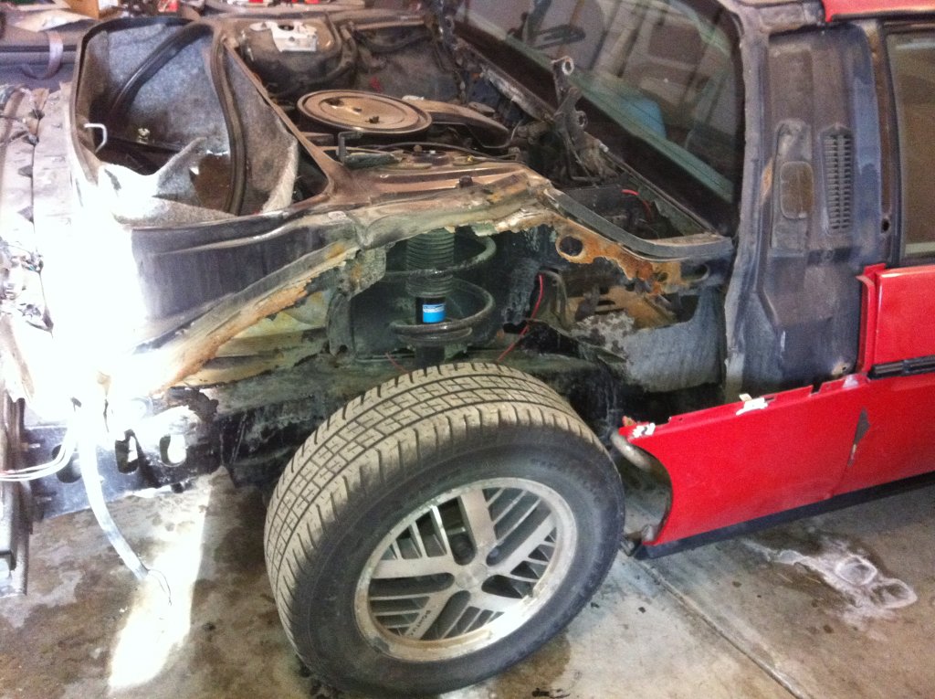

RWDPLZ
MAR 12, 02:17 PM
You did it the right way, they're not glued in like that from the factory. Only the very bottom middle of the trunk is stuck to the frame, the rest just floats and conforms to the shape of the trunk. Sounds like he glued it in place so people couldn't see the trunk corner condition. Rust in this area is a well-known thing when looking at these cars now, he probably did a little research and found this is the first thing informed buyers look for.
Don't end up with THIS:
It's a ***** to fix.[This message has been edited by RWDPLZ (edited 03-12-2016).]
