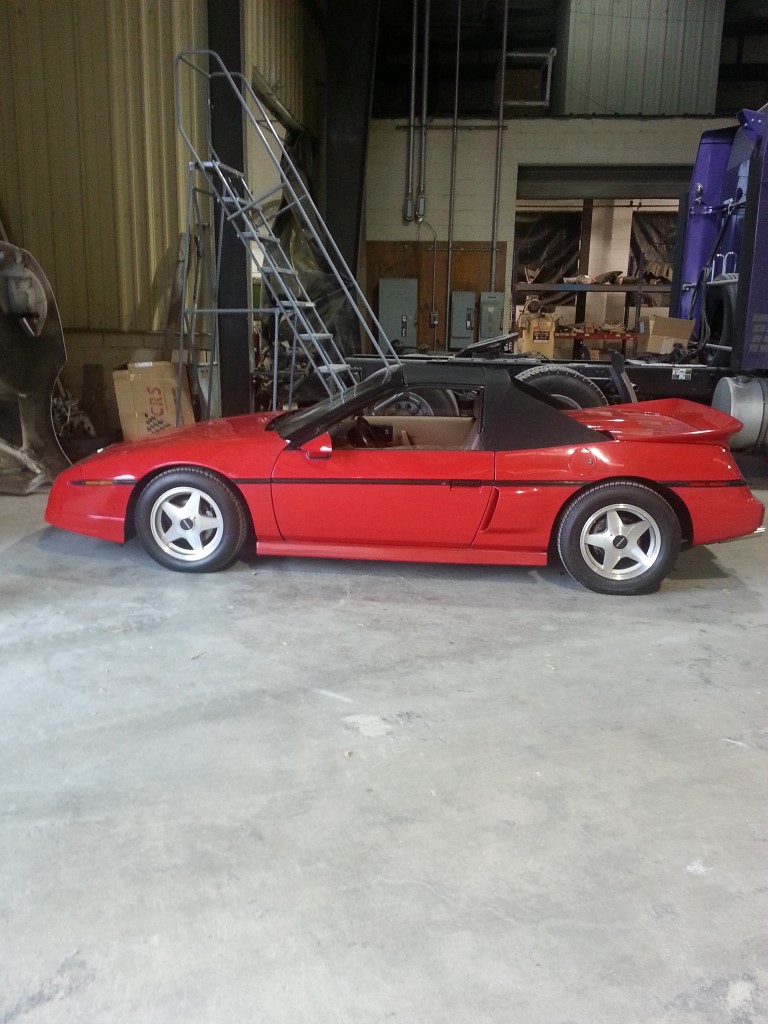

Thanks for the info. I see no reason that it couldn't work. I just wondered if anyone who had done it could share any info. But what's postred here gives me some food for thought. And yeah.... that Cosworth looks like it's FI'd. Just never saw (or at least never noticed) that one, before. But then, I wasn't looking.
What is the point of all this? A few weeks ago, a friend bought the Automoda / SD4 that I posted about. It runs like kwrap. (Actually, at this moment, it doesn't run at all. Blowing fuel pump fuses. ) I'm about to go through it and see if I can make it run. And make it run well.
