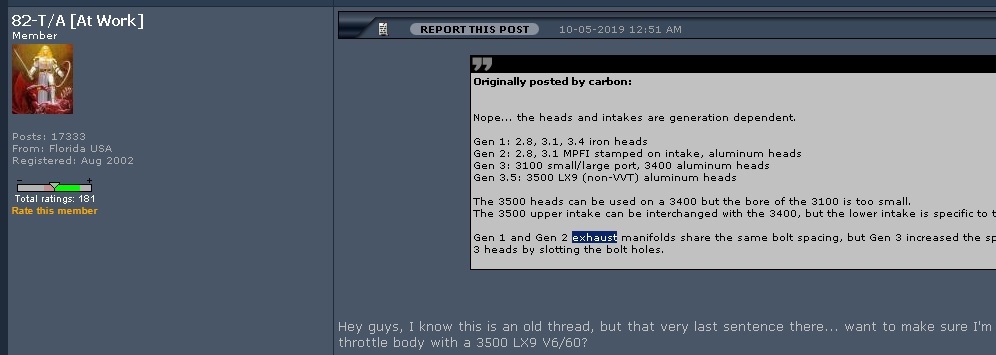

Hey guys, I know this is an old thread, but that very last sentence there... want to make sure I'm understanding correctly. Is this telling me that I can possibly use my original red 2.8 Fiero intake manifold and Holley throttle body with a 3500 LX9 V6/60?

OCT 05, 01:03 AM
Notice the key word... I highlighted it for you.
"exhaust"
That last paragraph is in reference to exhaust manifold compatibility.
No, the red Fiero intake stuff won't work with the aluminium heads.[This message has been edited by pmbrunelle (edited 10-05-2019).]
