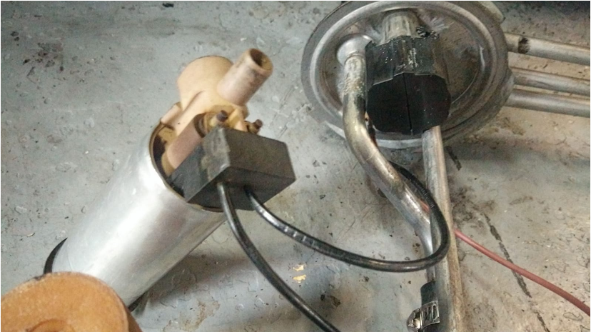

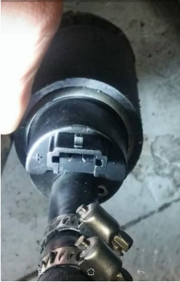

Replaceing my fuel pump for a higher volume pump, When removeing my old pump there was a black wire and a almost tanish wire going to the old pump. My new high flow pump came with a pig tail connecter with a ( red + ) and a ( black -) wire. Want to make sure I'm connecting the right wires.
Also can I connect them with heat shrink butt end connectors or will the gas eat them?

Black is ground and tan or grey is positive.
I have used the heat shrink tube covered butt crimp splices you can get from any auto parts store inside the tank for a number of years and have never had them deteriorate. ------------------ OVERKILL IS UNDERRATED Custom GM OBD1 & OBD2 Tuning | Engine Conversions & more | www.gmtuners.com
