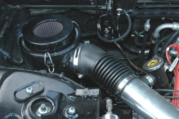

JUN 09, 02:12 PM
Must have been moved. On my Indy all 4 relays are clustered together. The fuel pump and A/C relay are right above the signal lights relays just to the right of the decklid hinge.
