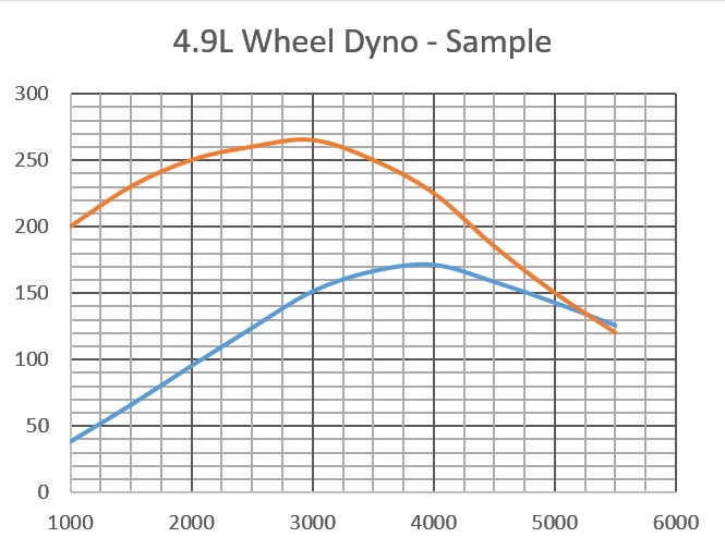

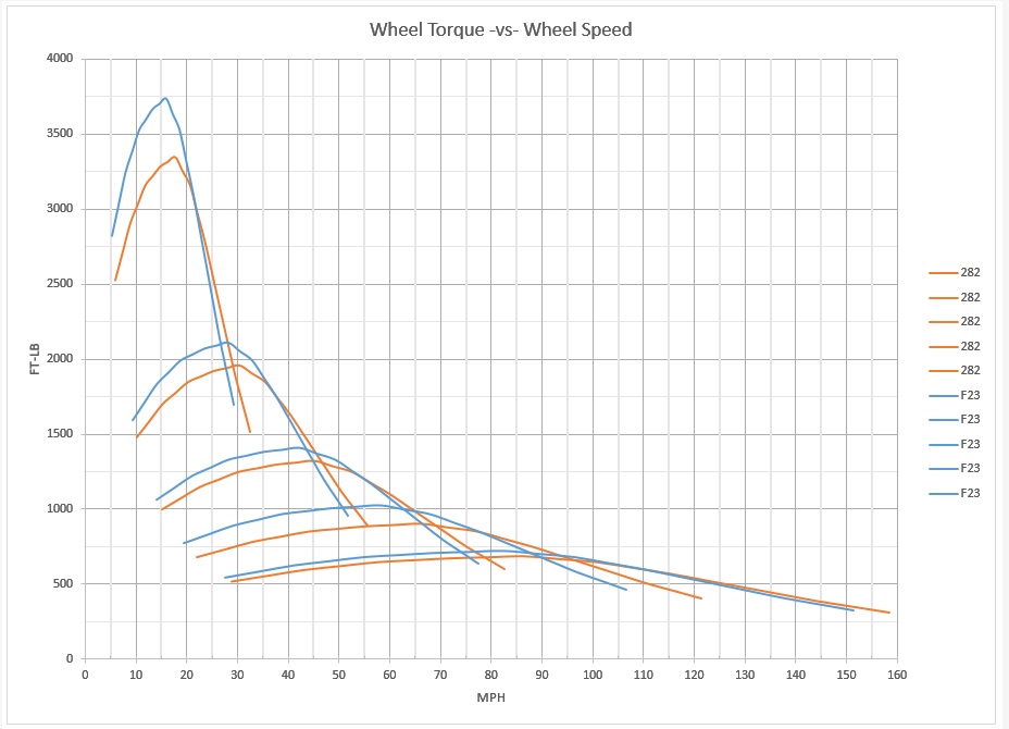

FieroWannaBe
AUG 23, 12:03 PM
This premise is further precipitated by the crappy gearing available with most Getrags or F23s. Probably the most popular manual tranny options in use. Yeah... I get it. The ratios suck for a "tractor motor", but it's still a lot more fun to drive than the automatic. |
The ratios are terrible for just about any engine combo. They sit somewhere In between a close and wide ratios, with a very high 1st, no matter the transmission choise. Standing starts are the worst. But if you stay out of first the f23 is probably the best option behind this engine in my opinion.
Here is a Thrust chart I made of the 282 vs the F23, with a sample power curve I made up (based off of the two dyno graphs I could find online

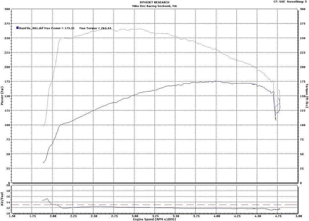

 Heres a photo of a carbureted 4.9L (with a 2 barrel) dyno. It belongs to Arns85gt. It shows a lot better top end the the other dyno I referenced, which was Lous_dias. Not sure what was done to either engine but i believe lou_dias had a allante intake, which has extremely long runners relative the standard TBI manifold, and his tune was pretty rich up top.

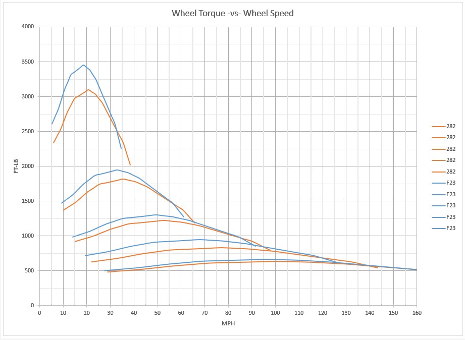

Here's a thrust curve with carb'd engine numbers.

FieroWannaBe
AUG 24, 10:02 PM
| quote | Originally posted by lou_dias:
Ended up with 196 rwhp before they made some changes to improve idle and we settled where it is in the video... E85 fuel but heavy wheels. |
From the looks of it, if both engines have factory cams, it looks like the Allante intake does shift the peaks down about 1000RPM...
AUG 25, 09:26 AM
I finally tuned it... Ended up with 196 rwhp before they made some changes to improve idle and we settled where it is in the video... E85 fuel but heavy wheels. |
Pretty cool! That's actually about what I'd expect from an otherwise stock 4.9/Allante setup.
| quote | Originally posted by FieroWannaBe:
From the looks of it, if both engines have factory cams, it looks like the Allante intake does shift the peaks down about 1000RPM... |
I actually never thought about that aspect of it (as opposed to absolute peak power and torque) but it does make sense.[This message has been edited by Raydar (edited 08-25-2020).]
