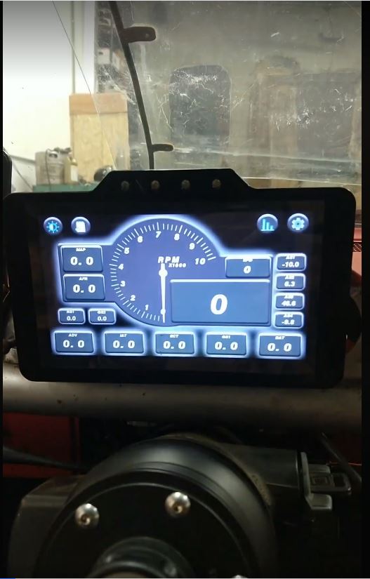

Heading to the famous Road America next weekend.... Bought a 7in digital dash and a bunch of pressure sensors to get ready for the stressful oil situations that RA will put me in. I am also going through the front suspension again, adding in the baer roll center adjusters again. Adding another degree of camber out back to help with the removed sway bar. WIll have some pics and updates in a few days.
darkhorizon
SEP 10, 11:10 PM
Dash is in, pressure gauges working but havent put the final touches on the megasquirt driving the RPM/volts/temp yet.
