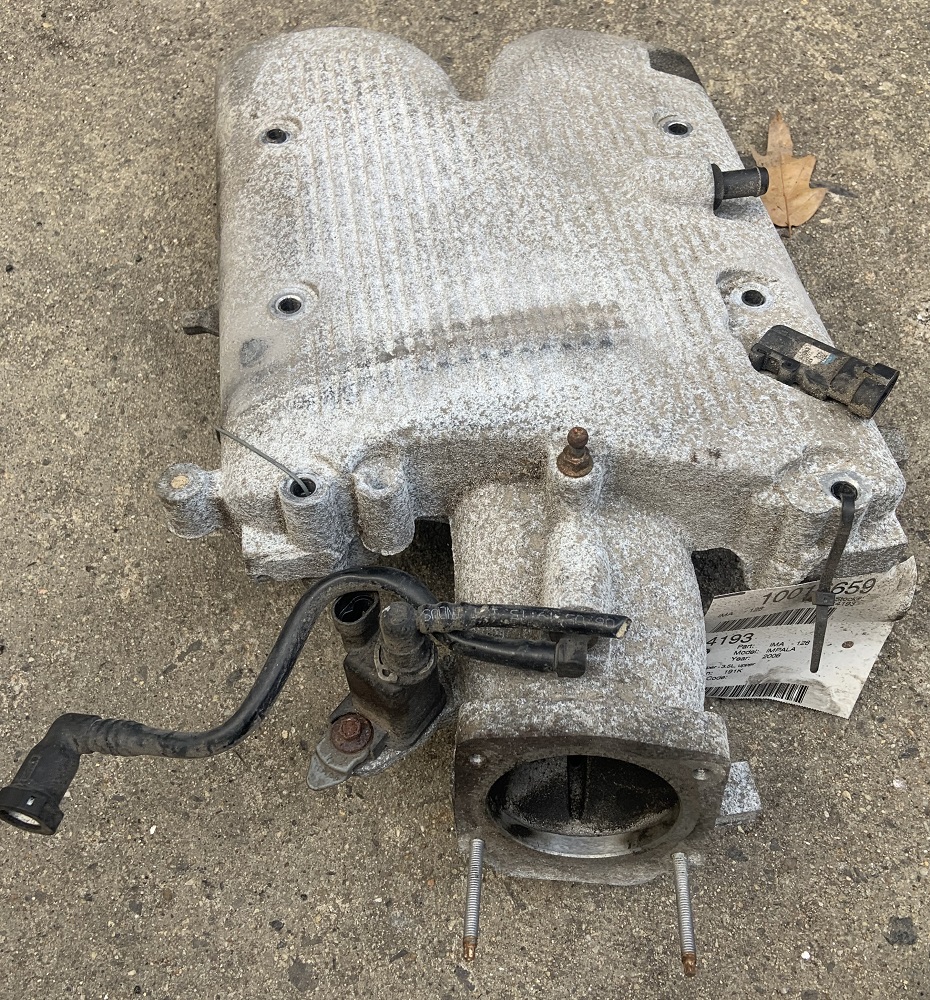

I also bought a N* throttle body off of Ebay, it was surprisingly the most plentiful and cheapest I came across in the correct size, and all the additional junk is below the throttle body instead of above which is good for hood clearance, and the throttle cable will end up on the correct side too. I went with a 2000-2005 Deville TB. No MAF on this 3900.
Going to go get an LZ4 intake at a yard soon, hopefully this week, maybe they will straight up trade me for my LZ9 intake, it is definitely more expensive with the actuator.[This message has been edited by zkhennings (edited 03-02-2021).]

Picked up an LZ4 Intake from a junkyard today, N* throttle body comes in soon and I ordered some 3/4" aluminum to mill an adapter plate between the two.
