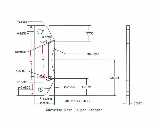

Rear adapter
This drawing is incomplete. Anyone have the rest of the dimensions?
One if these 2 dimensions are needed to make a part from this print.
Unltd1 MAR 04, 08:32 PM
Originally posted by HellYes:
Rear adapter
The drawing is complete... at least to my eye... the centerline is drawn... 3.5625... so the complete dimension is
7.125
hope that helps you
-Darius
HellYes MAR 04, 10:33 PM
The part is not symetrical, so I cannot assume a center line that is not properly noted as center line is correct. The line is not dashed, does not extend through to the other sde, and is not noted CL. Just making sure I am not paying to have junk made. Cautious Stainless is not cheap.

Unltd1 MAR 05, 01:05 AM
I think the part is symetrical, the only thing that is not is the location of the holes...
I agree it would be nice if the centerline had been chain dotted... but from every other outer dimension on it... it looks symmetrical to me...
have you tried emailing/pm-ing cheetah to ask him... since he had some of these made... (I'm assuming from the same drawing)
(also I must apologize, I just now read that someone else's post having given the measurements the same....sorry to have duplicated..)
