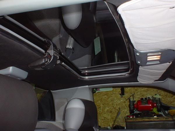

Gokart
JUN 02, 08:01 PM
| quote | | Originally posted by rogergarrison:I still say to use the contact cement. My black naugahyde headliner has been up in the Ferraro for over 7 years and not the slightest hint of ever coming loose. Sets closed up out in the hot sun a lot too. Cant beat $3.50 @ quart either. I used it on the whole interior of the GT40, ceiling, doors, trim panels, floor carpet, etc. Also what I used to build complete interiors in motor homes and conversion vans. Never have had a single failure I know of. |
Took your advise...again! I just did mine over and used contact cement. It was tricky job because I converted my solid one into a cut-out for the sunroof clip I just installed.
