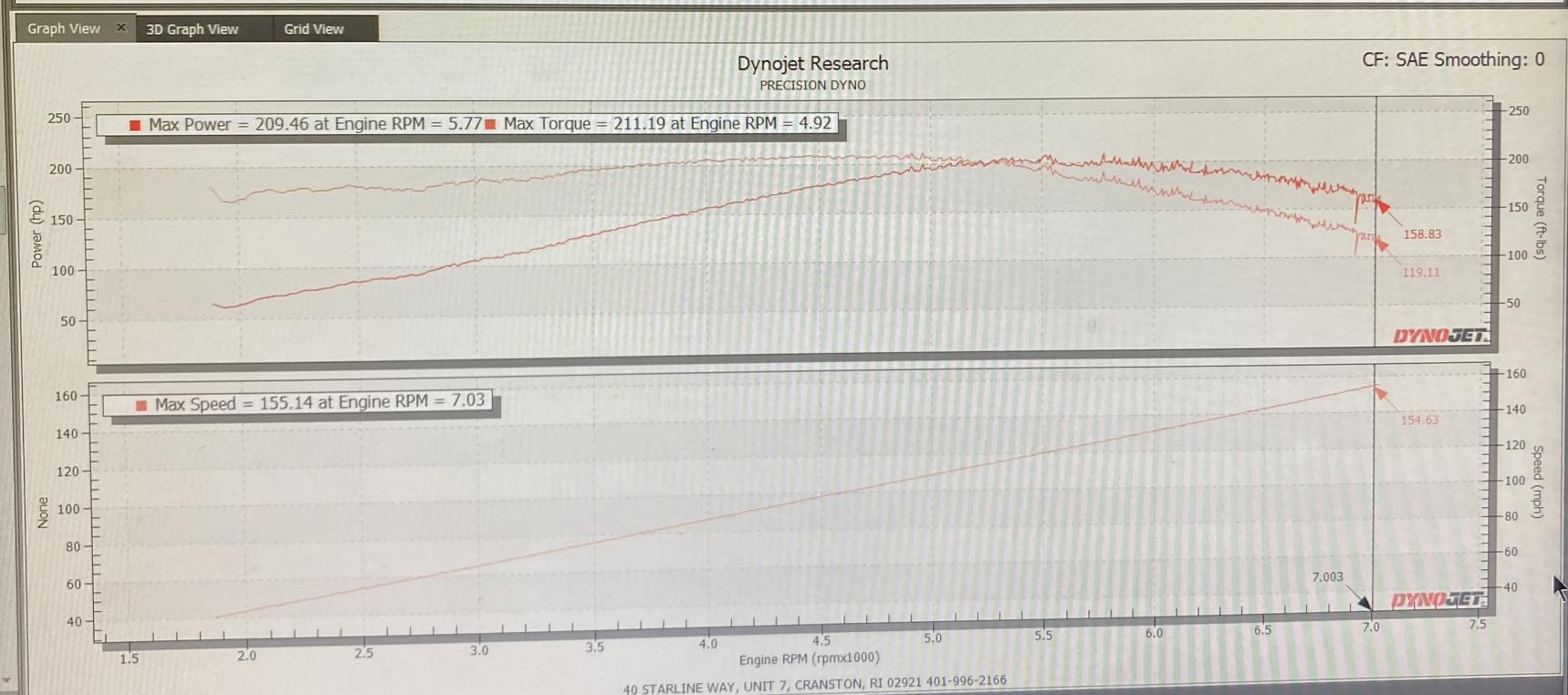

              lou_dias
              JUL 02,  06:00 PM
            Here's the 7000rpm dyno before we did any tuning that day...
  It was running too rich - below 12:1 for this run.  7000rpm = 155mph ... still made 159rwhp at 7000...  The cam is supposed to peak around 6200 so once it does that then it will be right and good.
