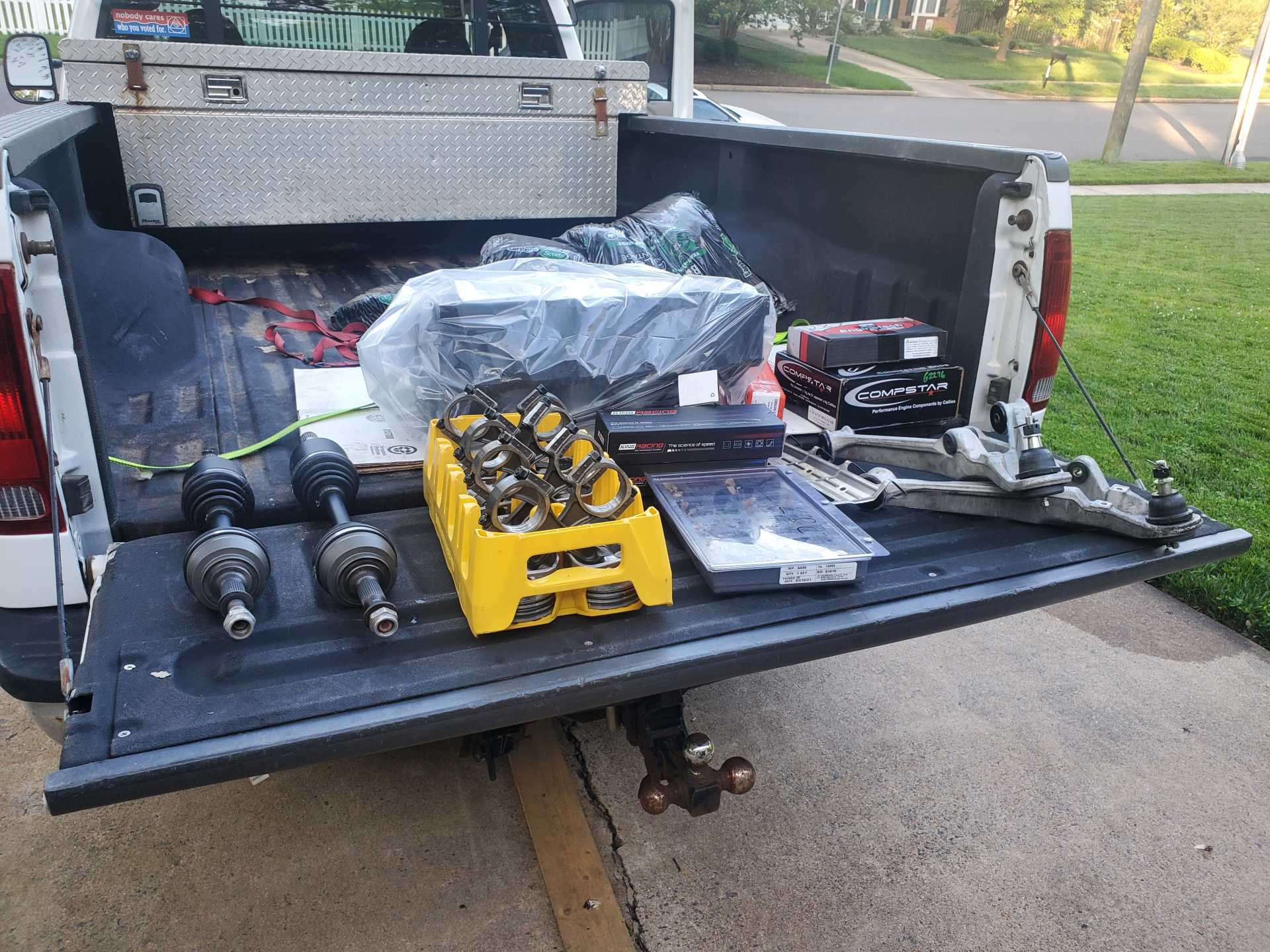

18 (or 23) weeks later, depending on how you count axles arw finally here.
Engine is for my other toy (c4 racecar); have to build the motor and throw it back in the car for a race in aug before I move back on the fiero.

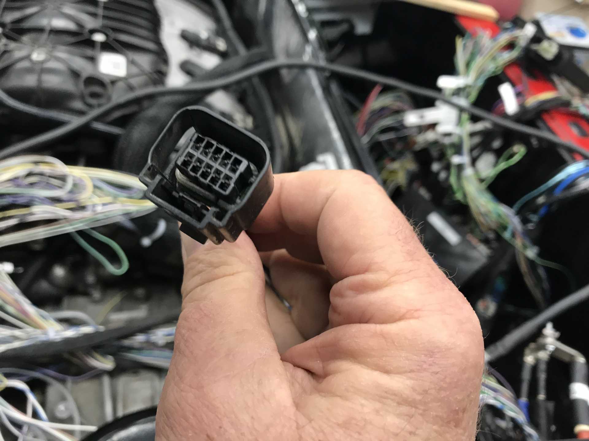

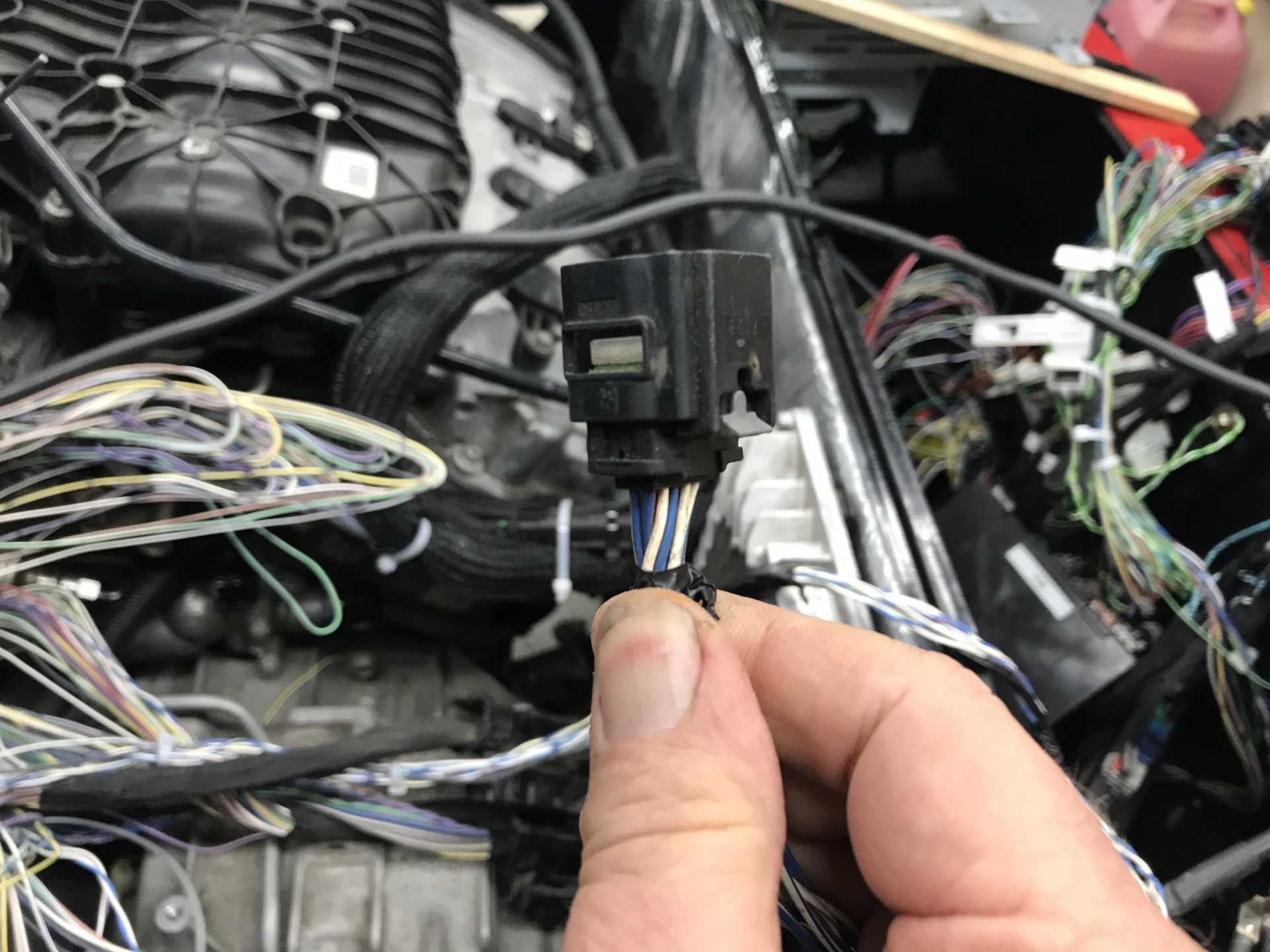

I'm plugging along with my LFX swap. But need to update my post. Can you recognize this connector on the LFX engine? it is 2 x 5 pin female and I forgot to mark it when it came out of the Impala. Any idea where it plugs into? Thanks Mike

I figured it out, that's the connector to the power steering controller. Which I cut off. I figured it out by buying a year's access to Mitchell1DIY for the impala. Cost me $30 to get complete documentation on the Impala's electrical and mechanical systems. Beats spending $475 for the Helm shop manuals. The Impala wiring is convoluted and confusing so getting good schematics really helps.
