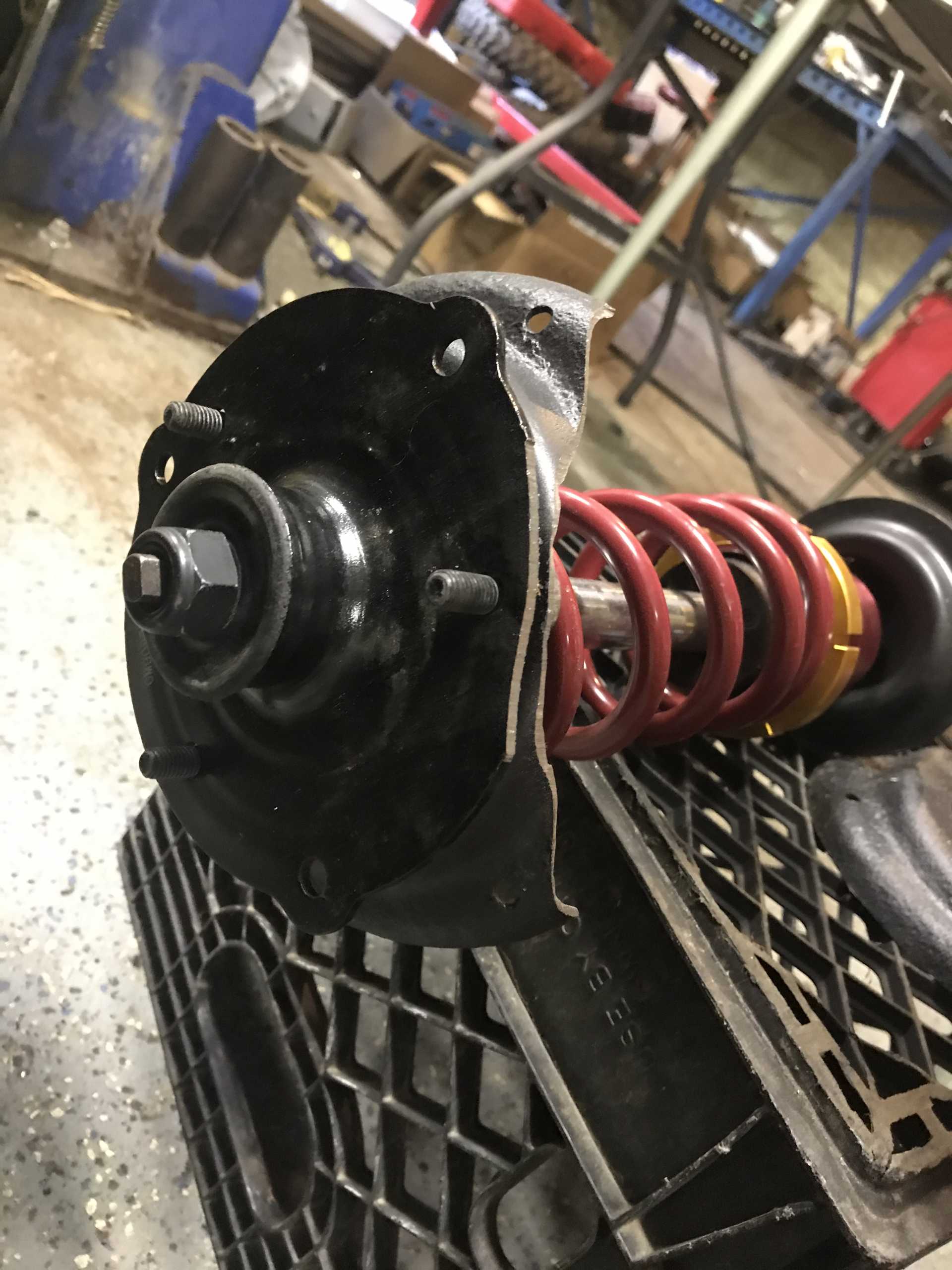

The coil overs barely clear. When I look into upgraded suspension it will be tricky. These coil overs are temporary.

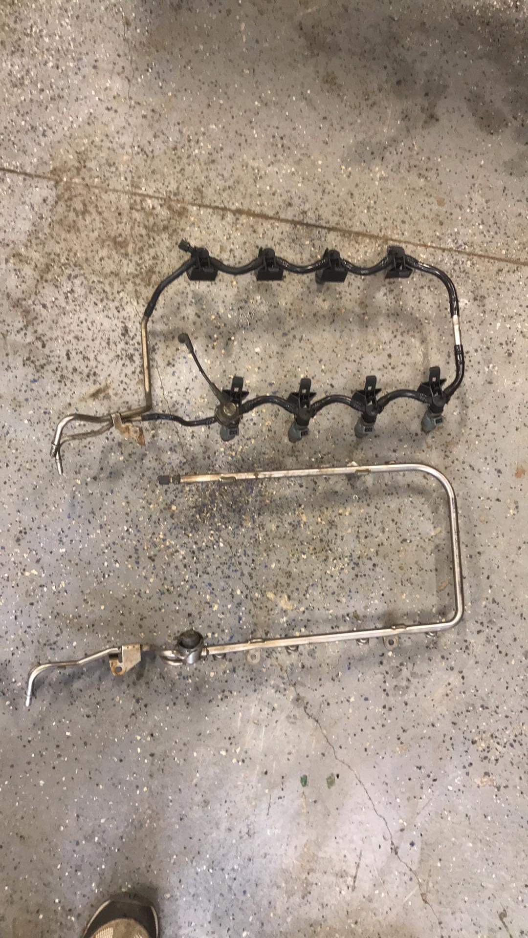

I was at the scrap yard, and they only had one Northstar of the year I needed. It was also not picked over at all go figure. The plastic rail was recalled, and replacing mine was on the back burner. I got this rail for $10 and installed it in 20 minutes so I call that a score.

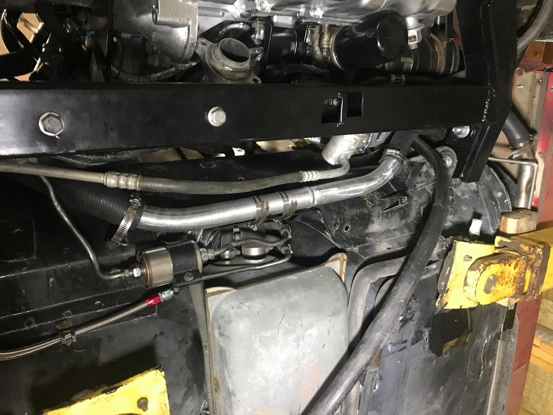

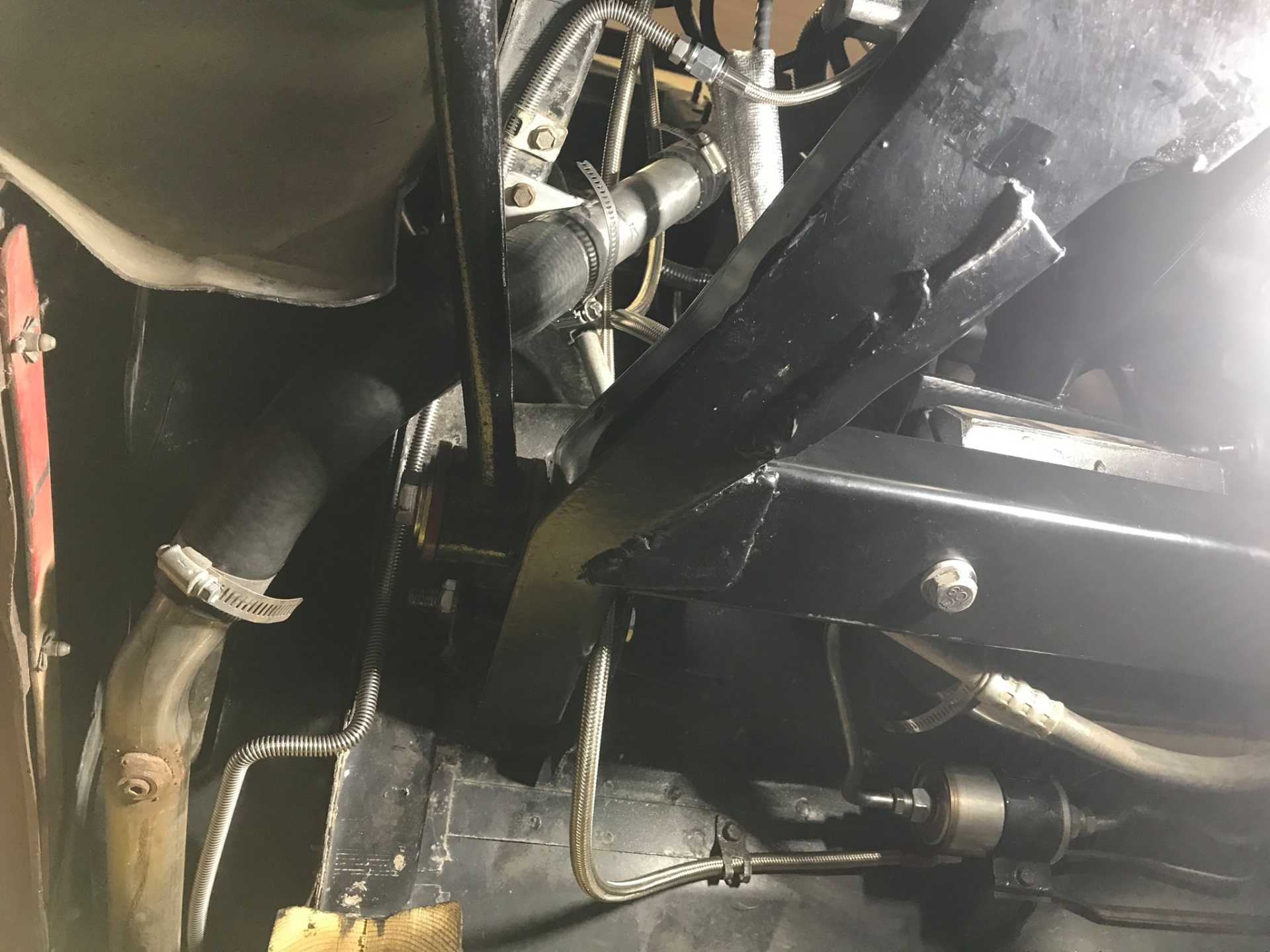

In October, we mocked up the cooling hoses and got them done. I had part numbers for the rubber hoses that are lost in my pictures. My friend had Jeep cooling hoses layimg around that actually were close to what I was looking for. I took them to Oreilly's and told them the idea I had for hoses. The nice guys at Oreilly's searched their inventories and found hoses that worked perfect. From there we used scrap aluminum pipe to connect the rubber hoses.
I think they turned out great.

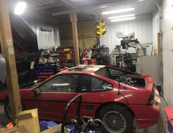

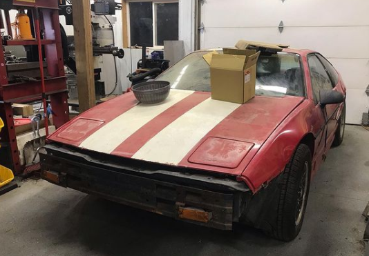

Here is the car.

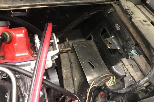

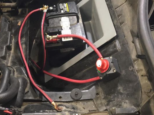

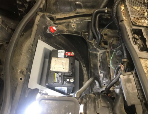

Here is the battery tray mockup. The tray is from V8 Archie. The on/off switch is some $20 off of Amazon that seems really well done.
Here are some wiring mockups. The wires run along side the bottom of the car.

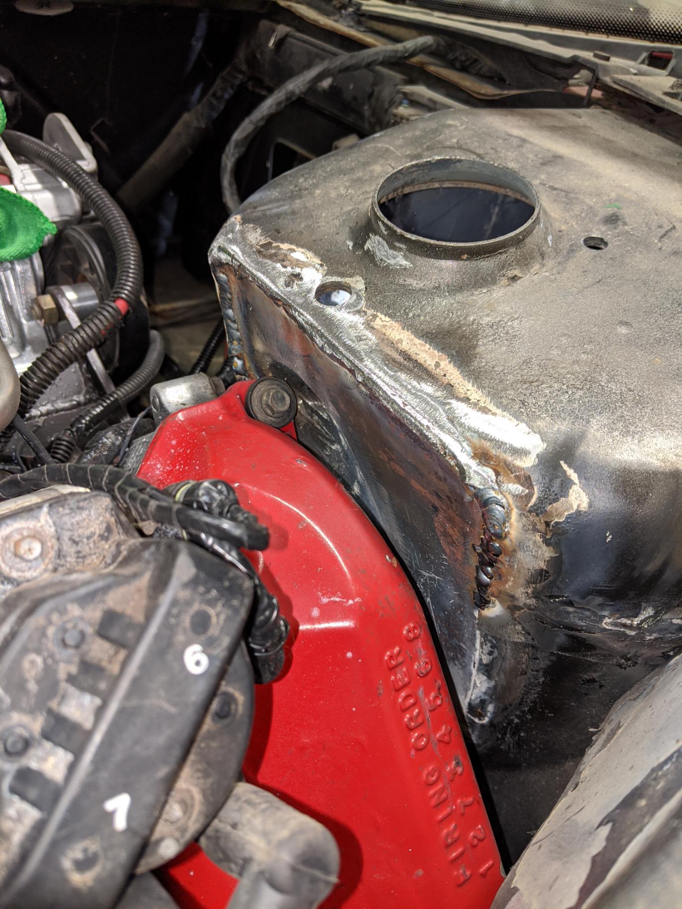

Here is the bracket for the expansion tank. I did a lot of research on which sort of tank was best. I have seen some Northstar tanks up from, I have seen some mounted in multiple spots in the rear. A Grand Prix tank seemed popular, as did an expensive Corvette tank. Ultimately I bought Dorman 603050. Its pressurized, you can see the fluid levels, and mounting it did not seem crazy since it was a nice shape. However, there had to be an adapter made to jump down from 1in at the tank nipple, to the 5/8 hose of the Fiero. I will have to get pictures of it.

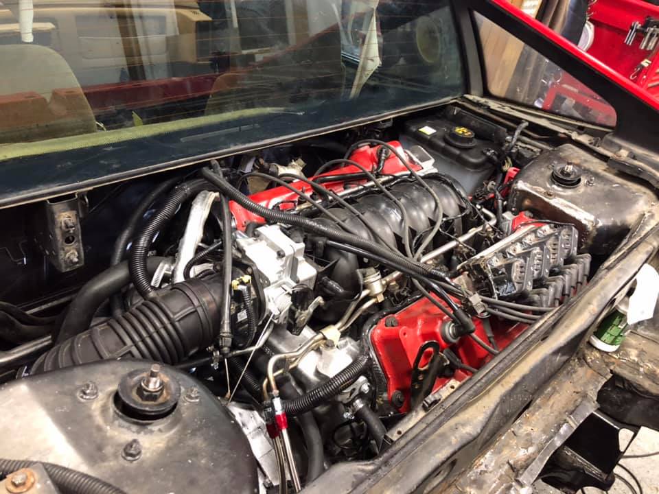

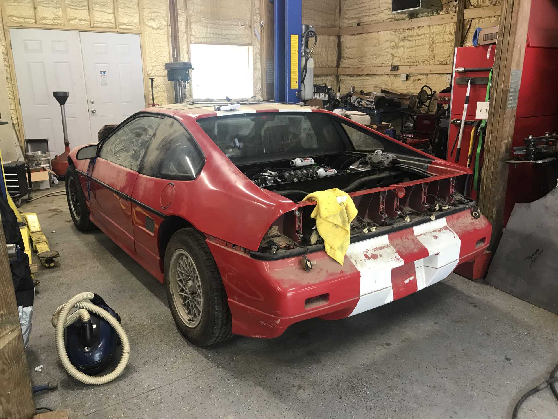

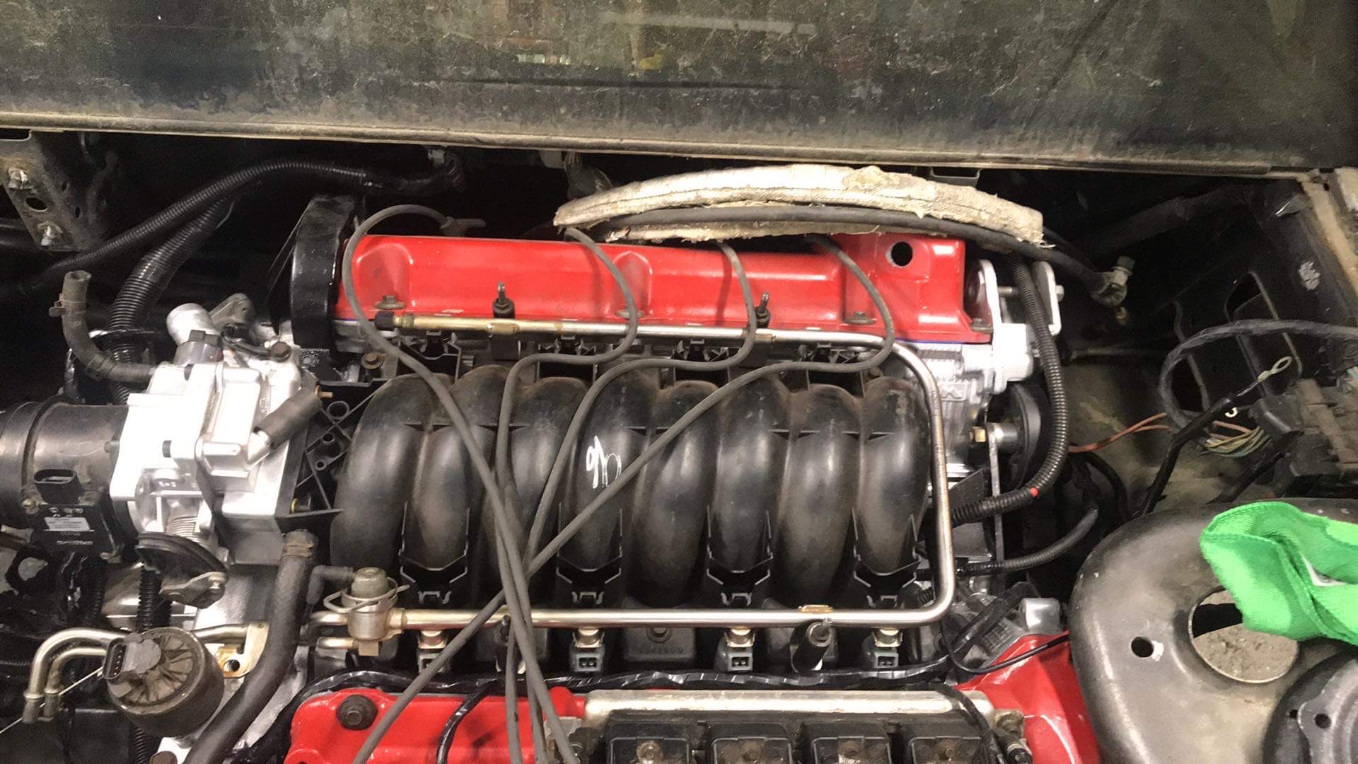

Here is the car as-is. It is kind of a bad picture, but you can see the tank mounted in the corner. The main ground is mounted at the bottom of the bracket of the tank. The engine ground is mounted on the other bolt of the same mount. There is a positive battery junction on the strut tower as well that I wired in yesterday.

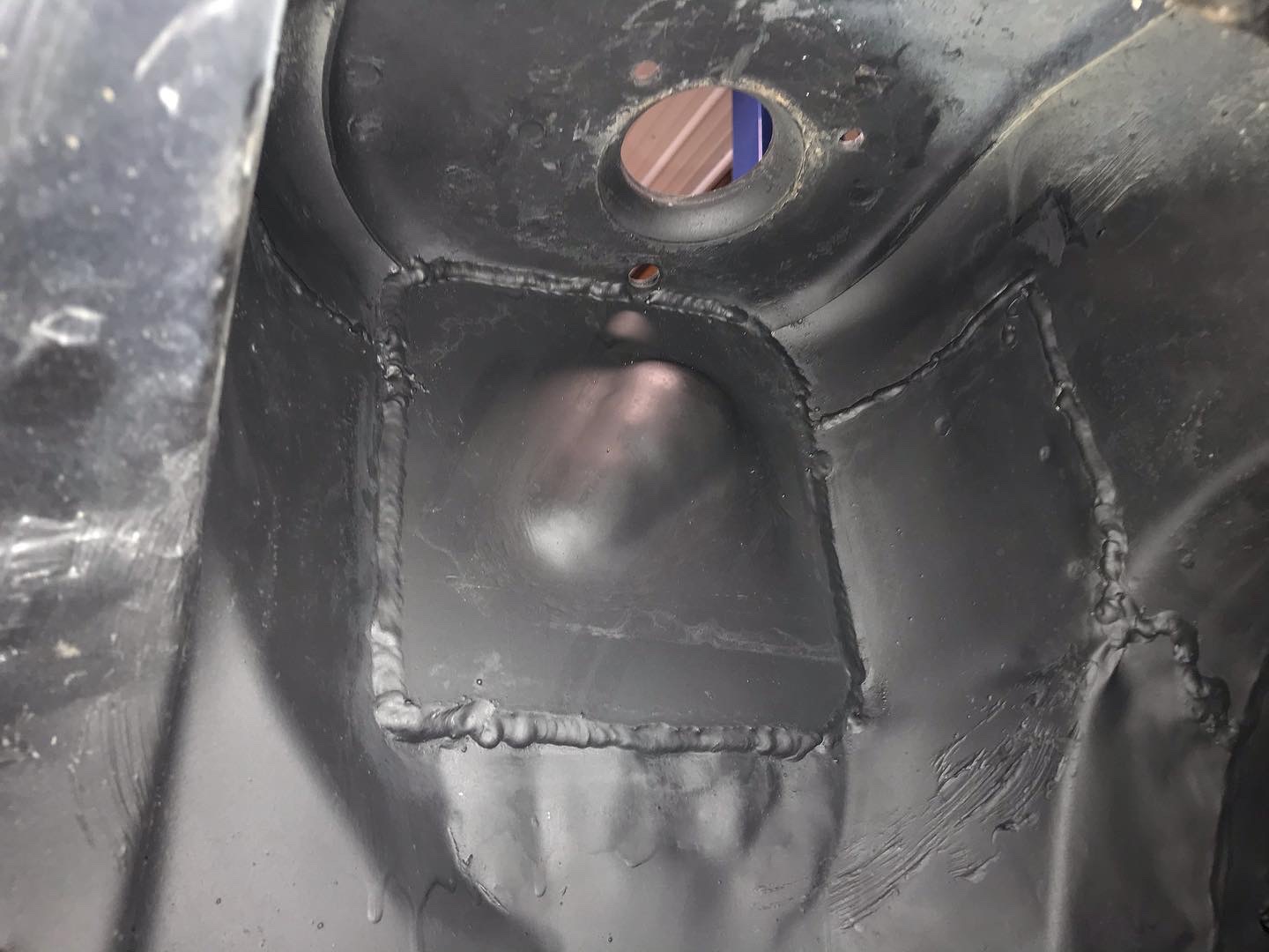

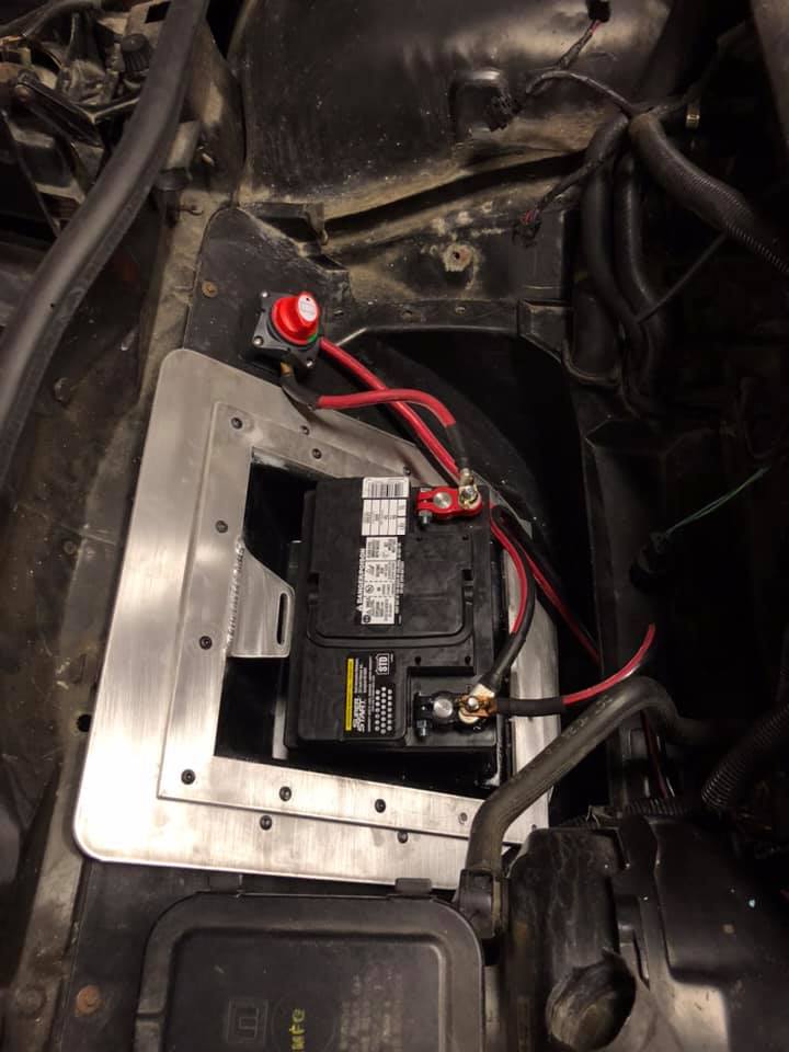

Here is the front tray that is pretty much done. The aluminum was cut with CNC, and is just for added support up front, as well as having a battery tie down location.

To go from the waterpump outlet (upper connection) to the left coolant pipe, check out this combo:
CarQuest 20898 + Moroso inline filler neck + 1.25” straight hose coupler ~2” long
I've wanted to try the Corvette tank on the left side of the engine bay... I believe the Corvette tank has a concave spherical surface meant to fit over the Corvette's wheel house, so it may work with with the Fiero wheel house on the left side of the engine bay.
What application did your rear cam cover come from? The close corner looks different than the ones I've seen.
