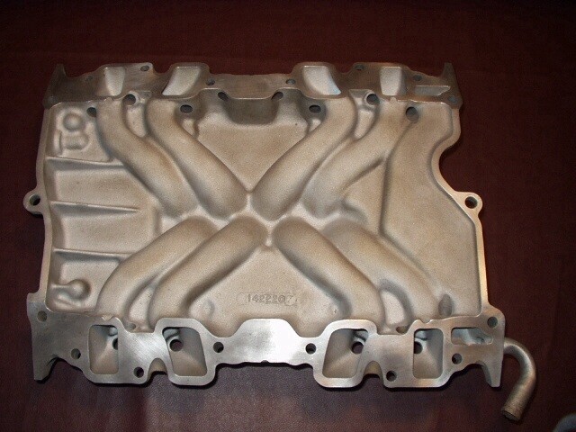

One cannot forget the intake. I believe it is where the real restriction lies in this engines, since they route the runners around the pushrods, forcing the air to accelerate twice, and then make the short radius turn into the valves. They air loses a lot of energy. You can see how the engineers curved the center ports in the head and intake to try to work around that. The standard TBI intake has very small ports and a dual plane setup. It is set up for low speed torque, and short of re-fabbing entirely it is stuck that way. The Allante intake is very similar in setup to the TPI intake, very long skinny runners. Shortening them with and porting combined with a larger plenum will help shift the power curve, but it really needs to match the cam installed. I have a old 4.5l I decided to not swap years ago because after looking at all this, I just couldn't see it meeting my power goals per dollar spent. At the time 250whp NA seemed like it was almost too much work with available components at the time (2008-ish) But it is possible, if the entire top end is designed with a common goal in mind. Cam, Intake, Heads.

.jpg)
 the holes for the pushrods pinch the ports heavily.[This message has been edited by FieroWannaBe (edited 08-20-2020).]
