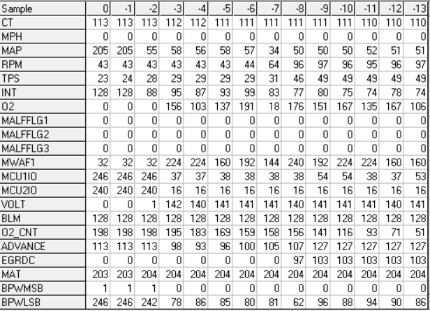

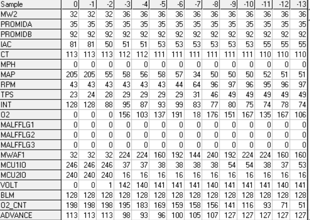

Also something I am noticing is in the data pics I posted before the MAP sensor drops drastically with WOT is that normal ?
Gall757
APR 12, 10:27 AM
| quote | Originally posted by Monkeybean007:
Also something I am noticing is in the data pics I posted before the MAP sensor drops drastically with WOT is that normal ? |
Probably. What data pics?

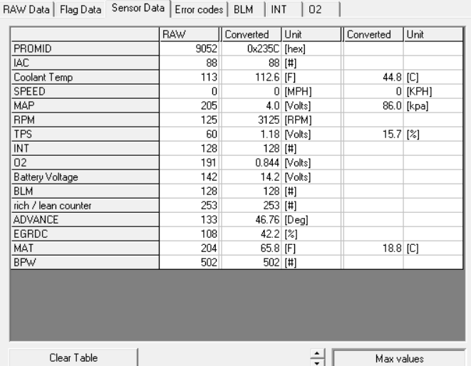

These were the readings I got, yes I know about aldlview it worked once for me and then has never worked again 😂
Gall757
APR 12, 05:14 PM
Oh yea....Coolant temp is not functioning...... what's up with that?

edit: Although if your ADVANCE is 46 degrees as it appears to say....it won't be running well.[This message has been edited by Gall757 (edited 04-12-2020).]
