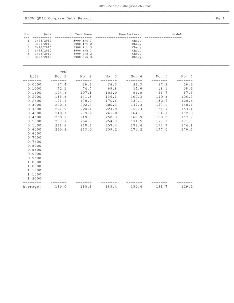

I may or may not plan on a turbo, but, like Chuck has said, info is real spotty. I did find a post with some LZ9 flow tests (Joseph posted here a while back)
Quick search showed a Motor Trend page with the flow vs cylinder number (HP = 0.25714 × CFM × No. of Cylinders), so in theory the 3900 heads are capable of close to 400hp at their peak, n/a (used 255cfm since the lowest from 3 cylinders was about 260cfm and I like to err on the safe side of estimating)... granted that would be a max-effort cam designed for n/a, but since turbo is the "in" thing nowadays, you can have the best of both worlds, so long as you build it properly and don't get hasty in your endeavors.
