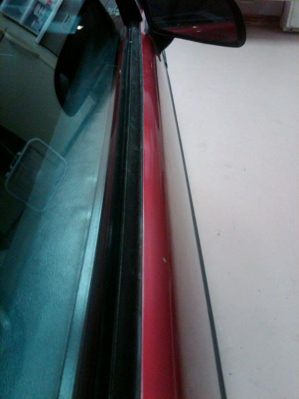

1988holleyformula AUG 05, 12:44 AM
Spent the evening installing DIY-Stu's passenger side outer dew wipe. Many, many thanks to both OP and Stu for making my car look that much better!
They really needed it
Looks like new!
