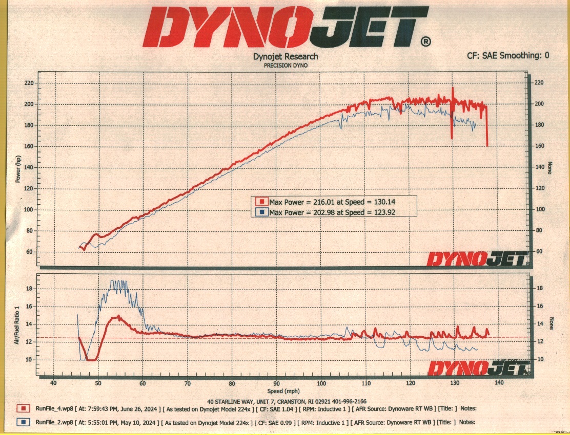

lou_dias
JUN 28, 08:40 AM
So we tried leaning it in this last run and started losing some power on the top end. :/ Ran out of time and had to leave. I think I need to just keep throwing fuel at it as Rei advised me starting at 4600 and on. I've definitely left some power on the table...but you can clearly see that lighter wheels = more power.
So basically you can go back and look at my years of old dynos and add 13-14 hp. But basically it scales with rpm... It looks like a 20 rwhp difference at 6200rpm...[This message has been edited by lou_dias (edited 06-28-2024).]
