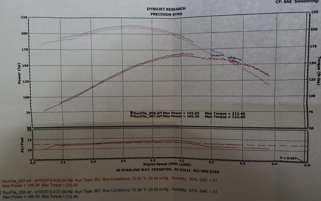

Last month's not-done-tuning yet dyno:
After this I discovered someone had regapped my plugs back to .060 hence the misfires (are down to .050" now) and I also made some adjustments to lean out the top end some more but I haven't had a chance to go back to the dyno yet to "record" the results. Though the axle-snapping performance is telling...
