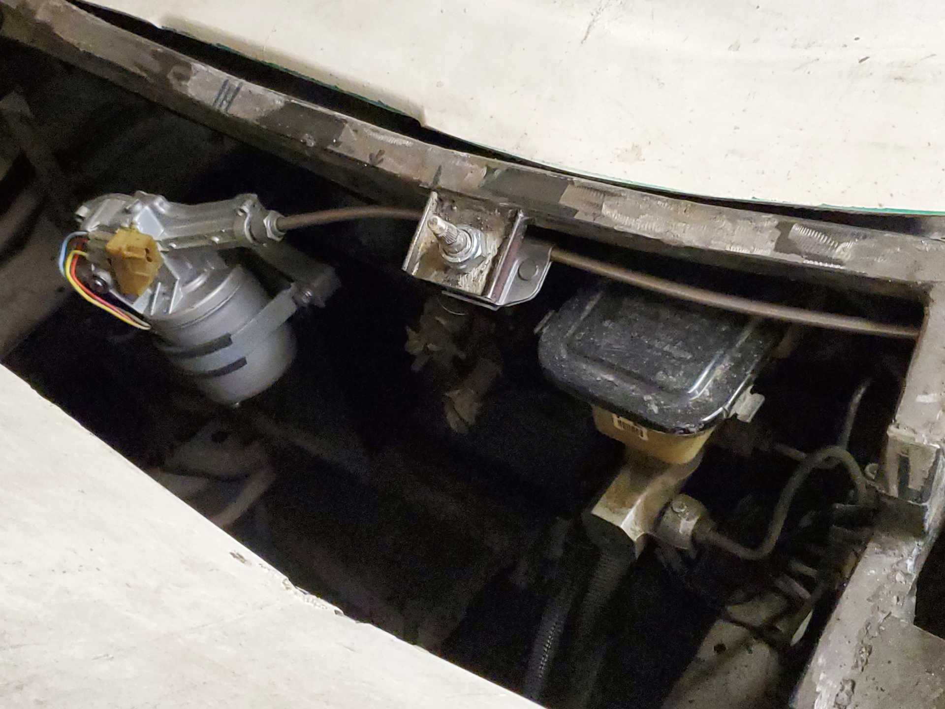

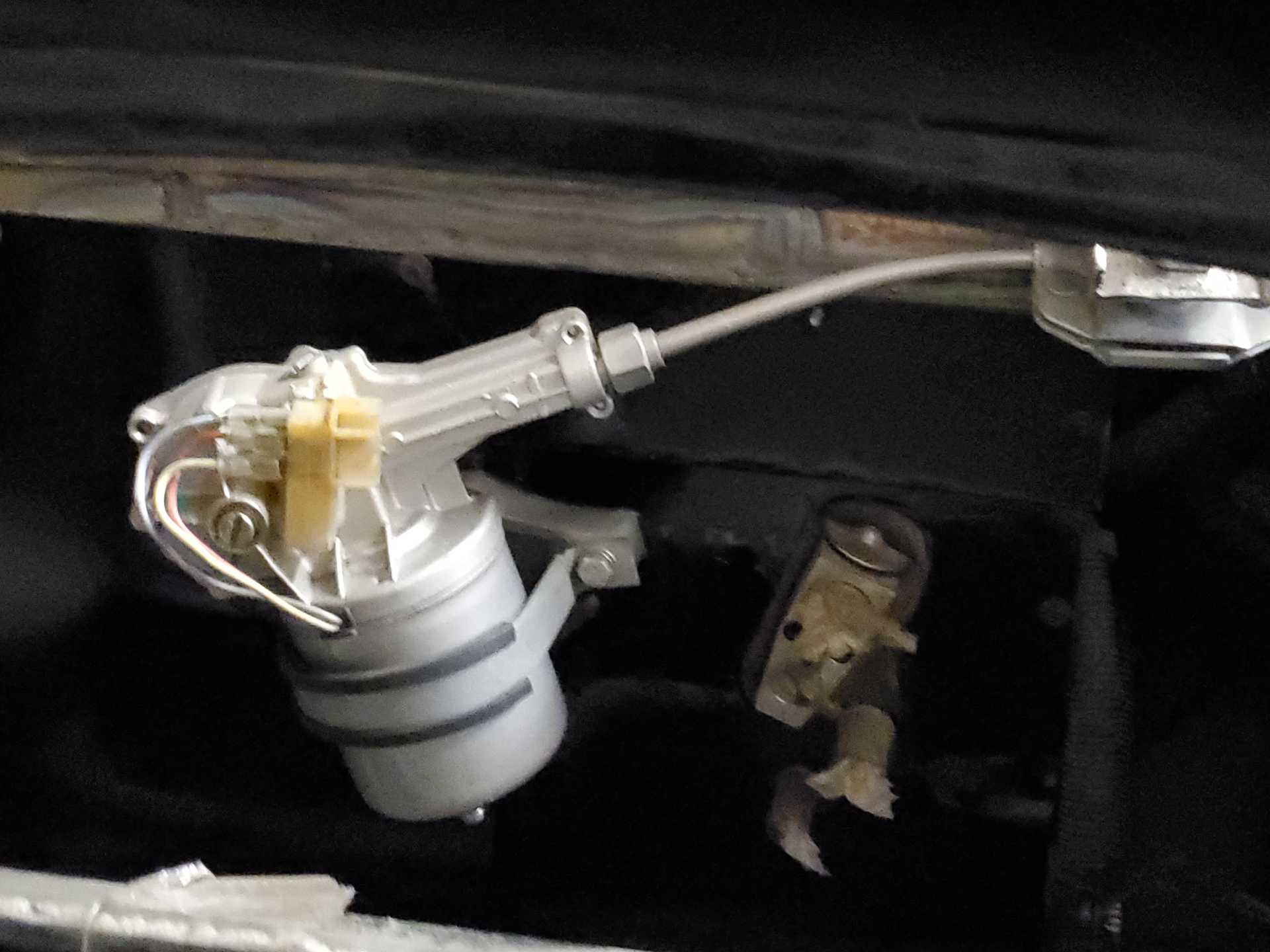

I finally got the wiper system installation completed, minus the wiring. I really like the versatility of a cable system. Much easier to install when space is limited. I welded a wiper motor mounting bracket to the HVAC housing. Before anyone asks, yes I can still remove the brake master cylinder cover.

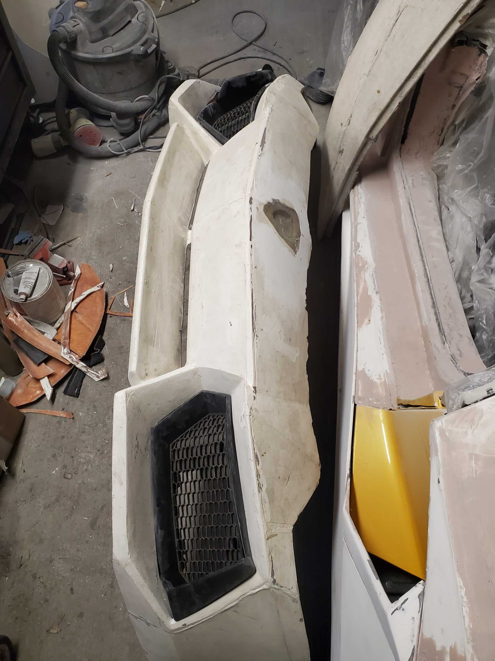

I installed bonding bolts in a number of places on the front bumper. The bumper fits really well, so I will only use the bonding bolts to secure it.
For some reason the bumper didn't already have a recess for the nose emblem. I cut an opening for the recess and fiberglassed it. I was able to use a piece of a real Aventador front bumper as a mold. I'll still need to finish it with some body filler.
Lastly, I began installing the front vent grills and grill housings. The grills and housings are oem. Unfortunately, the bumper clearly wasn't designed to match the oem bumper so it's going to take lots of finessing to get them to look like they belong there. Once I'm happy with the fit, I'll add some mounting brackets.

I finished installing the front grill housings. This involved a lot of fiberglass trimming to get the oem housings (the black parts in the last pic I had posted) to fit into the front bumper. Once they fit, I spent several days fiberglassing some brackets in place on the inside of the bumper that I'll be able to secure the housings to. They seem to fit quite well.

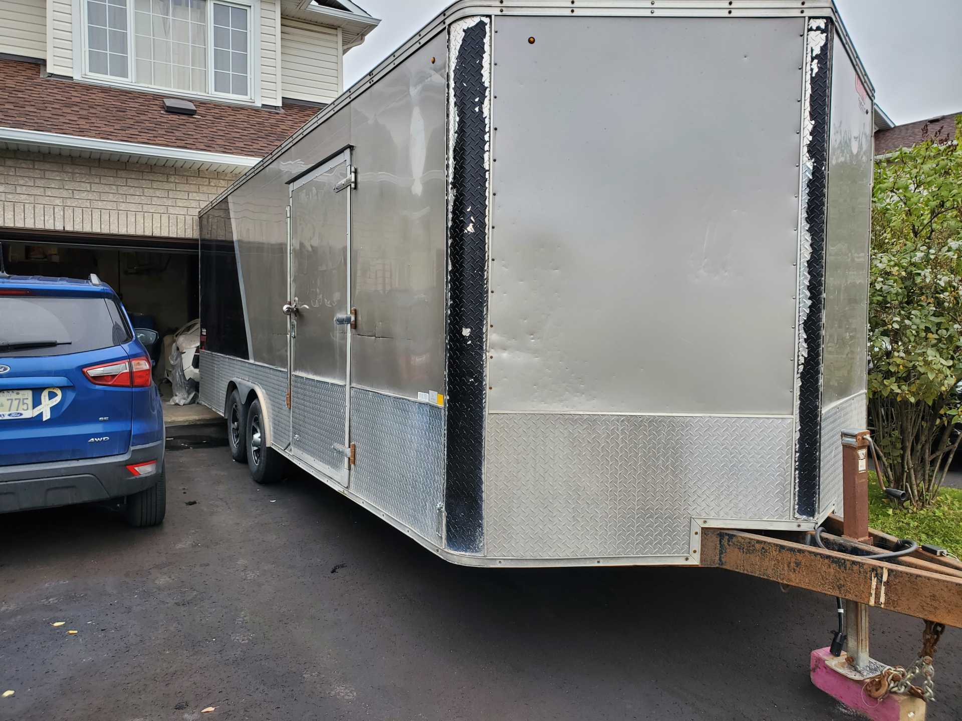

I wanted to give an update of the Aventador project. Unfortunately, the project will be on hold until next summer.
:sleep:
However... there is some good news associated with this. We sold our house in Ottawa and are moving back to Nova Scotia! (Just a stone throw from Bloozberry). We just broke ground on our new house... which will also come with a garage actually big enough to work in. .... finally!
Until then, since I won't have access to a garage, the car will get a new home...
I look forward to getting back on track next year!
